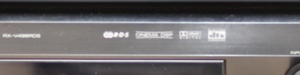

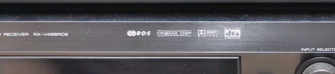

This is the starting point for the two bodies, both set the same, both jpg's cropped at 100%. As you can see, it's not just a fine adjustment needed.
I'll run through this process with all my lenses tomorrow.
D90
D7000
The second shot seems to be from a bit closer - maybe you're closer than the Minimum Focussing Distance (just)? Try from around 2m rather than 1.5.
Only looks than way because of the D7000’s slightly higher resolution. They are full resolution crops from the image centre. I didn’t express it very well saying “cropped at 100%”. The RDS logo was the focus point. Those two images were at about 2m. Not that far off infinity for a 50mm 1.8.

So, what I've done is mount the D7000 on a tripod, set it at single AF, centre focus point, matrix, ISO200, Aperture pri, F1.8, remote firing, subject about 2m. Also put a bounce flash on in TTL for better lighting consistency. Then ran through 20 shots + and 20 shots -, letting the camera settle for a few seconds between setting the fine tune menu and remote firing.
I was wrong about the actual focus point being behind what the camera was taking. Best image appears to be -5. The +-0 is from yesterday. Focus point was again the RDS logo.
Again, full resolution crop from centre of image.
Interested to know if you think this is fine or if I need to do more.
+-0
-5
At some point I'll do other lenses but all the others are zoom, and if it means doing this for each of them at short, mid and long zoom, that's more than I can face right now.
Really appreciate the help on this guys.
if your happy with it now leave it .if the other lenses work o.k then no need to bother the adjustment only applies to that particular lens . glad you got there in the end
