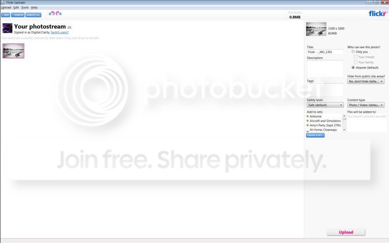

Before you do something as drastic as formatting the computer, try this program:
Flickr Uploadr
I use it for all my uploading and it works like a charm.
http://www.flickr.com/tools/uploadr/
Flickr Uploadr
As stated in the original post, i have tried both using the site and the uploader but both give the same results. I'm trying to avoid formatting the computer but its looking increasingly likely that i'll have to do it. Thanks for the replies guys.
