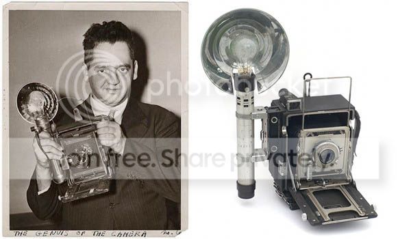

Nah too modern ..i generally use gunpowder and shoot at F/1016 to keep glare to a minimum :D:D
