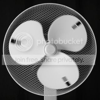

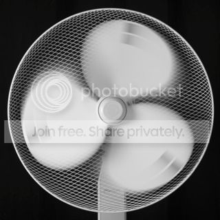

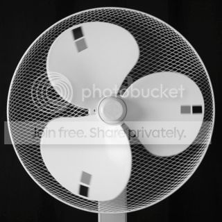

Appreciate your opinion on these pics if you would please - your estimate of the effective motion-freezing ability of the flash images in post number 2, compared to actual shutter speeds.

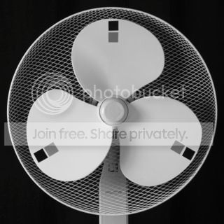

The first set of pictures below are for reference. It's a standard office fan with black and grey squares stuck on the blades. The images are taken with ambient/continuous light at actual shutter speeds to freeze the movement. Use these to compare against the flash pictures in the next post down, and give your estimate of what you think the movement freezing looks like in terms of shutter speed equivalents. Thanks.
It's harder than you might think. Flash durations can be difficult to measure, particularly with studio-type flash heads (voltage regulated). Unlike speedlight guns (IGBT regulated) where the flash pulse turns on and goes out very abruptly and is therefore easy to measure, the flash pulse of a studio head turns on quite quickly, but then fades away very gradually. The total burn time at different power settings doesn't change much, but the peak brightness changes a lot - that's what adjusts the exposure and it's basically the height of the peak that determines the movement freezing potential in visual terms. The industry uses a formula to calculate a 't.5 time'* that is supposed to represent the movement freezing ability, but it's well known to over-estimate by as much as three times the shutter speed equivalent. But what do you think? Can you put a number on it, using the actual shutter speed images for comparison?
Camera is Canon 5D2. There is some distortion of the fan blades due to the scanning action of the focal plane shutter, but it doesn't affect the blurring. The fan is spinning clockwise.
*t.5 is the time the flash pulse stays above 50% of peak brightness, as measured on an oscilloscope. There is another similar measure known as the 't.1 time' but very few manufacturers publish it.
Static
1/250sec
1/500sec
1/1000sec
1/2000sec
1/4000sec

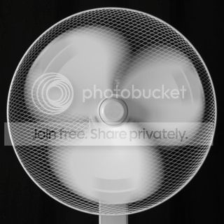

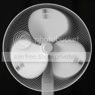

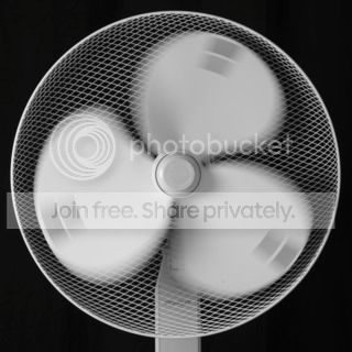

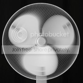

These four images are from are from three different flash heads, with the manufacturer's quoted flash duration (t.5). Using the images in the previous post for comparison, taken at actual shutter speeds, clearly these t.5 estimates over-state the real motion freezing potential, but by how much? If you can put a number on it, that would be great. Thank you :)
1) 1/4100sec (t.5)
2) 1/2550sec (t.5)
3) 1/2200sec (t.5)
4) 1/1200sec (t.5)
I'll have a go to get the ball rolling.
Pic 1, is obviously nothing like as clear as the 1/4000sec shutter speed shot. In fact, going by the darkness of the black and grey squares, it's not as clear as the 1/1000sec shot. I'd put it around 1/800sec in terms of the overall impression.
Pic 2, is not as clear as pic 1. The black/grey squares are a similar kind of tone to the 1/500sec shutter speed image, though visually the blur hasn't smeared so far, yet the blade outlines are less clearly defined. Tricky one, overall impression - maybe 1/500sec.
Pic 3, an odd one. The manufacturer's t.5 time suggests it should be more blurred than pic 2, yet it's definitely a lot clearer. In fact, it's very similar to pic 1, so overall impression 1/800sec.
Pic 4, not as clear as pic 3. The black/grey squares are lighter, and there's more blurring of the blade outlines. Overall impression, I'd say somewhere around 1/400sec.

OK, well here goes ...
Pic 1) - closest to the 1/1000 but I'd say slower, so 1/800 sounds about right
Pic 2) - more difficult to estimate as the blur of the squares is greater as is the edge blur. The edge blur is fairly close to the 1/500 image albeit that image has "longer" squares so 1/500
Pic 3) - this looks closest to the 1/1000 image to me, edge blur is very close and the depth of grey is also very close so I'll stick with 1/1000
Pic 4) - this looks the most blurred to me, but the 1/500 looks just a touch blurrier and the edges of both seem similar so I'd go with 1/600 I think.

#1: 1/800
#2: 1/320
#3: 1/500
#4: 1/400
I't's interesting that if you only look at the primary squares they all appear to be in the 1/500-1/800 range comparatively. And there's really not a lot of difference in the tails (it seems the exposure shifted slightly in the last image). I find it interesting that there seems to be no apparent relevance of T0.5 to T0.1, or rather "stopping power." It seems the characteristic of the tail curve is flat enough that it makes little difference.
