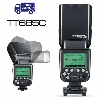

Firstly I am not a Canon user, however, I have had good results with Godox flashes and they are relatively cheap for what you get. Check this one for compatibility with your camera ?
I am sure some Canon users will be along with more detailed advice.
Like yourself I was initially disappointed with my on Camera Flash and wanted to experiment without spending a weeks salary, so I bought used and had a lot of fun learning and experimenting !

If you go down the Godox flash rout, as you progress any other good equipment you buy will work together . They are probably your best cheap flash option. For low light a faster lens will also help. For this have a look at Canons legendary 50 f1.8
