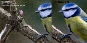

Only had this camera since yesterday evening and this is the first time trying it out. I've come from the 5D MKIV which is 30MP.
Are those processed? Are the cropped?
Can you share original RAWs?
F8, high shutter speed @ ISO 6400 on a cloudy day, shot noise will be a factor too. I think your sensor needs more light to be less noisy.
Processed and cropped.
Without seeing the conditions first hand it's hard to diagnose if there's a fault. Could be poor signal to noise ratio based on conditions and your aperture and quick shutter speed.
I've taken ISO 6400 photos that are clean as a whistle and I've taken some that suffer noise.
Could you take some images at 6400 in a test setting with abundant light hitting the sensor?
Tripod and 2 sec timer.
These are RAW and not processed.
Are these from LR or DPP with no noise reduction applied?
LR and no noise reduction, except for the right photo of the blue tit.
Like I said, that is not particularly unusual for those kind of cameras. But pay extra attention to the default edits LR applies to the images... things like sharpening/clarity/texture will increase the apparent noise.

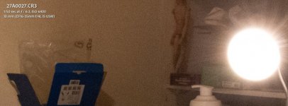

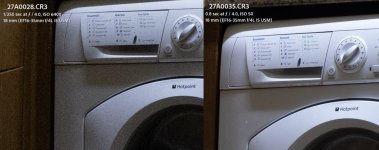

That could explain it... Cropping will reveal more noise and so does underexposed processed images. So noise depends on how much you cropped and processed too
Both not shot with the same exposure. Can't do a like for like comparison unless you have same exposure i.e. aperture and shutter speed.

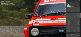

I regulally shoot at between 2500 and 5000 on an R5 and I am more than happy with the results, of course if you are going to 100% crop then there will be an issue but thats to be expected, and of course under exposing in low light also exadurates this.
I've included my adjustments in the screenshot below so you can see what I've done to the original Raw and how its come out. Even on this photo I've upped the exposure nearly 1 stop, increased shadows 75% and applied 25 dehaze. The image is sharpened with 40 and denoized at 25 luminance. No other noise reduction or sharpening applied - so pushing an ISO 5000 image quite far and its still coming out perfectly fine. Although the upload quality on this site is shocking as ever... so I've just stuck a copy on google drive to give a better impression (not sure how long I'll keep it up)
100% crop:
100% crop:

It's not great, is it? Hmm. A couple of questions:
- How much of a crop is it?
- Are you perhaps shooting through a window? These can destroy IQ, especially double or triple-glazed.
- Handheld or on a tripod?
- If handheld, is the stabilization switched on the lens itself? (note the menu option does not appear as the lens has IS, this is normal)
For birding shots with the same camera and lens at ISO 5000, I would expect a lot more detail unless it's either a big crop or a shot through a window.
Also, for a sitting bird you should be able to use a much lower shutter speed and so better ISO, either handheld with IS switched or on a tripod.
Not through window
Handheld
IS is on
I'm beginning to think there's something wrong with the camera body. Just my luck.
Photo before denoise. I have altered the colour of the image above, after I denoised it
