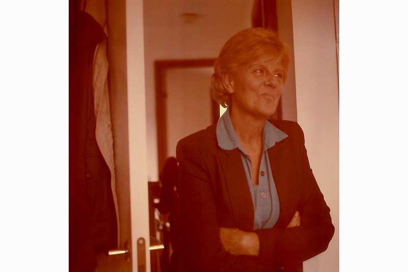

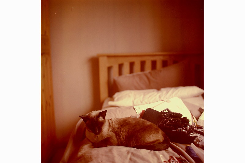

Today i collected my test role of 120 film. All shot with a yashica mat 124 g.
I understand the light meters in these things are less than accurate at the best of times so i used my om10 to meter most of the shots as i know this to be working just fine.
All shot with in-date fuji pro 400
All of the shots have a sepia tone to them and as you can see, something peculiar is going on....
imm012 by JBrooks131, on Flickr
imm010 by JBrooks131, on Flickr
imm008 by JBrooks131, on Flickr
Is this just underexposure at play or something else?
In my experience, underexposure turns the negatives blue when inverted, this looks more like overexposure

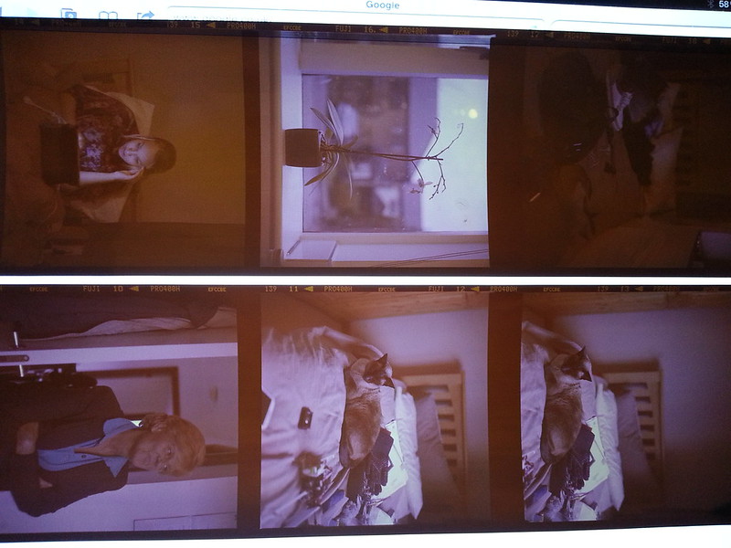

Did you scan them in or did the lab? Could you possibly take a picture of the actual negative (C-41 negatives are much more difficult to judge than B&W negs, but it should still offer some clues) and post it here?
Most of the detail seems to be there (and it doesn't look like a tortuous blocky scan), so I'm thinking it's definitely a fault at the point of scanning rather than any metering issues.
No they were dev'd, scanned and printed by jessops :(
Hmm ok so i Placed the negatives onto my iPad and they don't look sepia.
I'm rather confused.

Looks like a scanning problem..just copied the first one in Photoshop and selected image autocolor and it looked alright.

Looks like C41 processed E6

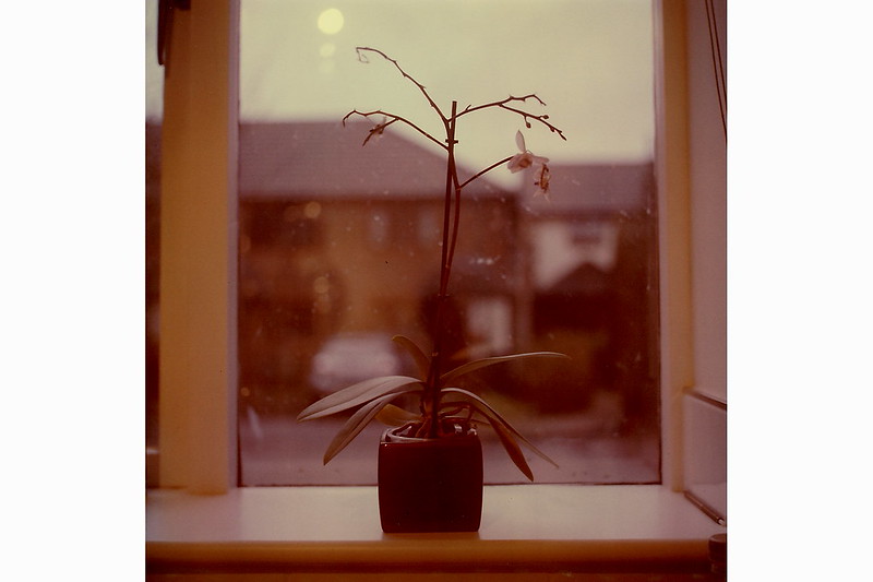

There you go, maybe needs a bit more work to remove slight yellow cast (assuming the sheets are white) but the first attempt was about 5 secs to do:-
