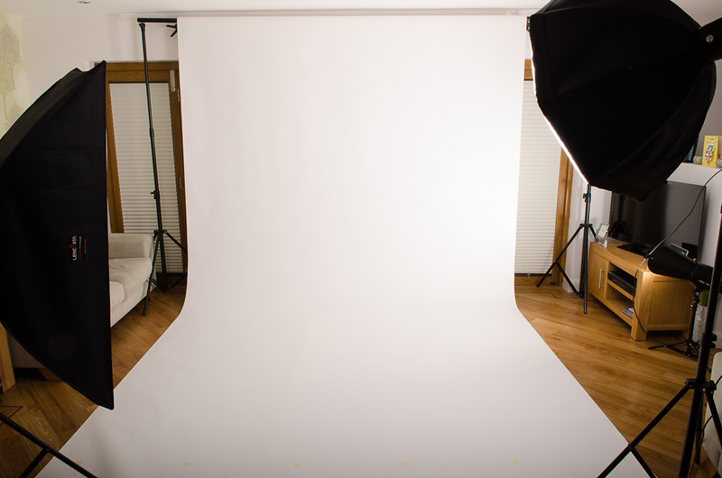

Here is the set up, I had the Octobox with Lencarta EP300 as the key, set as ½ power, which metered at f13. I had the other soft box (also with an EP300) for fill at 1/8 power and the background light (SmartFlash 200) set at full power, which metered about f16. I only have one background light and managed to get it reasonably even (I think?) using a Lencarta background reflector – to the right of the background, just in front of the TV stand. I think my main issue is a low white ceiling and a lack of space between the background / subject / camera. The background is white paper (2.75m wide)
Shots were taken at 1/250 sec, f13 with a D7000 & Nikon17-55mm f2.8
Studio-1 by Tunbridge Wells, on Flickr

I've just recently started experimenting with studio lighting and have a hell of a lot to learn before I am qualified to give advice...but, the balance between the lights doesn't seem quite right. Maybe position the octo (right) more face on so it is lifting the shadow on the left side of his face a bit? May also achieve something similar by increasing the left flash to 1/4 power or higher.
Thanks Shane, all opinions are valued, expert or not. As you say, it's a major learning curve! I was hoping to go on some sort of training course to get me started with the basics but haven't found one that suits. I was hoping Garry was going to do some more Lencarta ones in Bradford but I've had to make do with watching YouTube which isn't quite the same!

1. Although you've avoided the usual fault of overexposing the background and destroying fine details in the process, it's simply too large an area to light evenly with just one light, even when the light is fitted with a background reflector. It really needs 2 lights, but then you would have the problem of space. You can sort that out easily enough in PP but it would be nice to be able to avoid the problem in the first place. White backgrounds are quite a challenge in a small space.
2. FWIW I don't agree with shane, although that's just a matter of opinion. I don't try to get "even" lighting, and with kids, with interesting expressions and perfect skin, it isn't needed anyway. But it does seem to me that you've put your lights where there was room for them, rather than where they did the job best.Fine for your kids, not ideal if you photograph adults.

Thanks Garry, I was hoping you would comment. I had feared that I was trying to achieve too much on the background with just one light. The background reflector certainly helped but I may try and pick up another flash some time in the future. I would much rather get the lighting right as I try to do the minimum PP.
Can you elaborate on your point regarding the positions of my lights not being ideal for photographing adults please?

No, I'm not putting you in your place, just expressing a different opinion, and all opinions are equally valid, I don't have a monopoly.
This is much too big a subject for a forum post, but my whole attitude to lighting people is pretty much summed up here - watch the video, which is of a talk I gave at the TP convention in Blackpool.
Basically, my approach is this:
There are no rights or wrongs, as long as there is a known and defined purpose.
What I mean by this is that the first job of the photographer is to define (or understand, if it's a pro shot) just why the shot is being taken and what the purpose of it is, because the purpose defines the approach.
Kids are just kids.I love them to bits and it's really all about their expressions - you can use almost any kind of lighting, different lighting will produce different effects but it's hard to get a bad result.
An 18 year old girl, as another example, can be her dad's little girl, a student, someone out clubbing, a sexy girlfriend, and the choice of lighting (and pose etc) will define which of these she is in the photo.
Fast forward 10 years, she can be all of the above plus a mother, an employee, an expert on something or other, and again all of these are defined by lighting and pose.
So, lighting controls the emotions of the people who view the photo.But it does far more, it also enhances (or not) the qualities of the face, and minimises (or not) bad skin, poor bone structure and so on.
So, in a nutshell, just sticking the lights wherever there happens to be space for them works well enough for kids, but doesn't work well for adults whose features are less than perfect, or who may have put on a bit more weight than they're happy with. If you want to make (a woman) look young and sexy then a good starting point is to have a single light, high and central to the face. Create shadows that emphasise the qualities of her face. Don't just have light hitting her from all directions, that will broaden the face and age her.
Good photographers tend to use hard lighting to exaggerate qualities and soft lighting to hide faults. Often, there is a combination of both very hard and very soft light, that's where the skill lies, and where the knowledge becomes important.
What I'm talking about here is sculpting with light, rather than just creating enough light to produce a nice bright picture. That's what I try to do, and teach.
