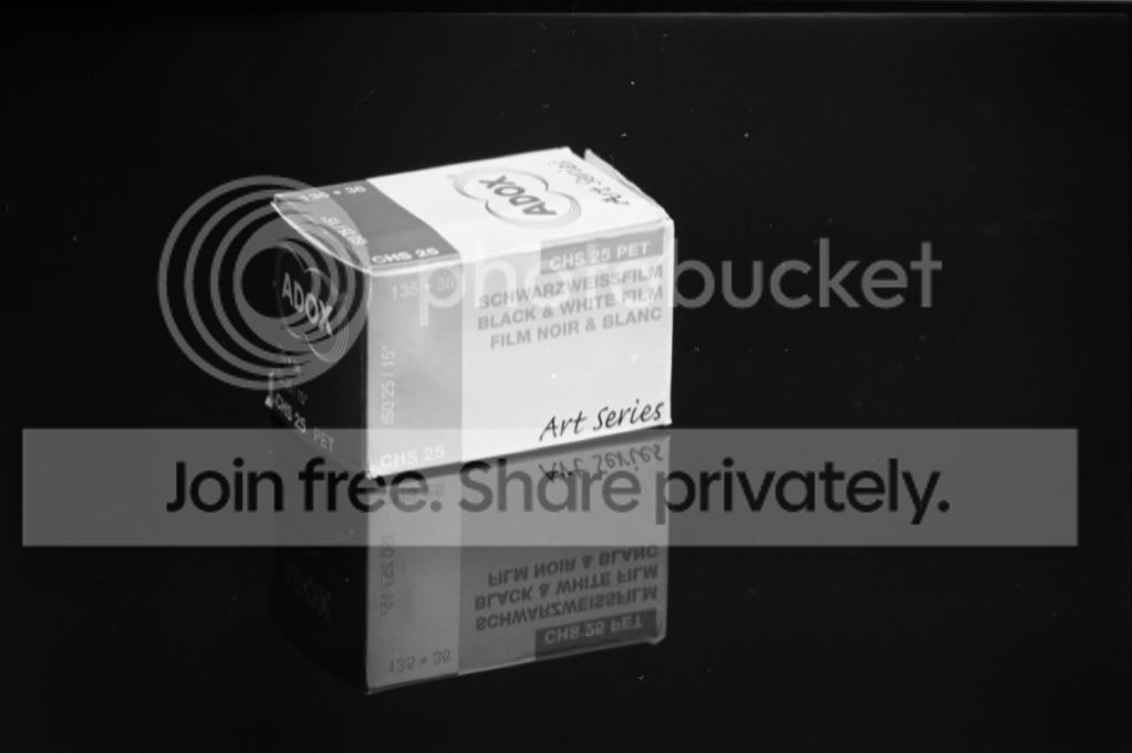

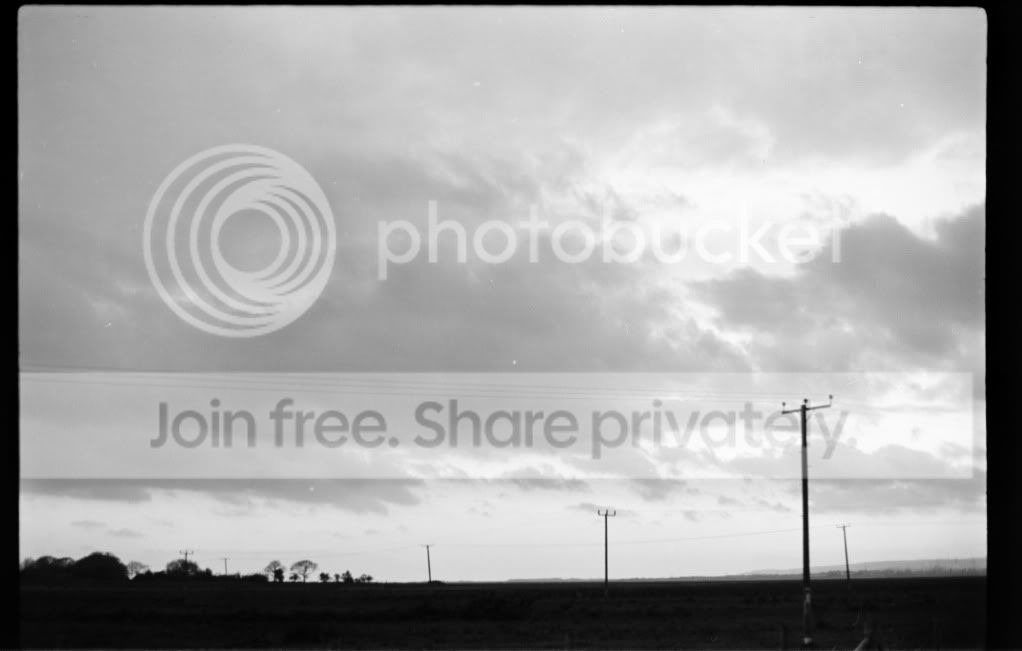

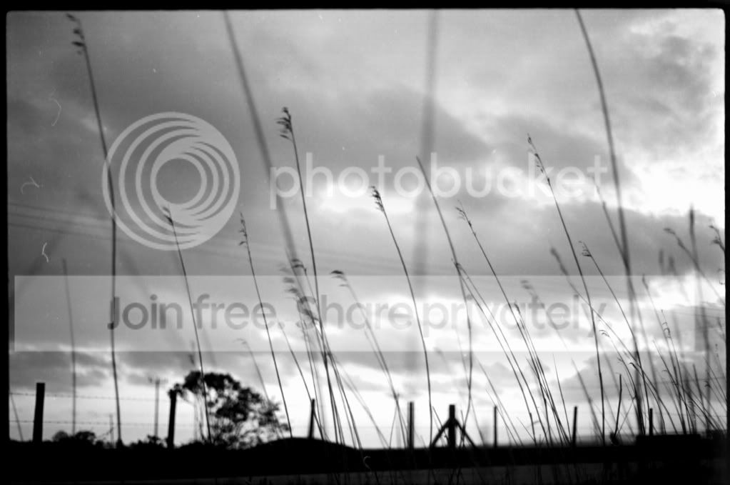

ok so im wired after work and thought heel to it here goes.
right, basically i havent taken notes on settings but the first is the camera on auto (om10)
the next three are shot with continuous lighting from the modelling lights in my strobes, metered and camera set with the manual adapter and aperture adjusted as prompted
and again, camera in auto mode
im looking at them now and thinking well they are not all that bad but perhaps i was expecting something more than i got?
most of the roll is pretty much the same including some experiments with trying to use my radio trigger for my e3 on my om10 and forgetting the sync speen for the om10
