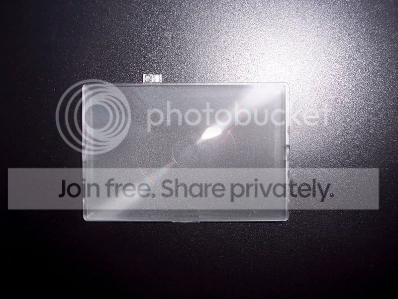

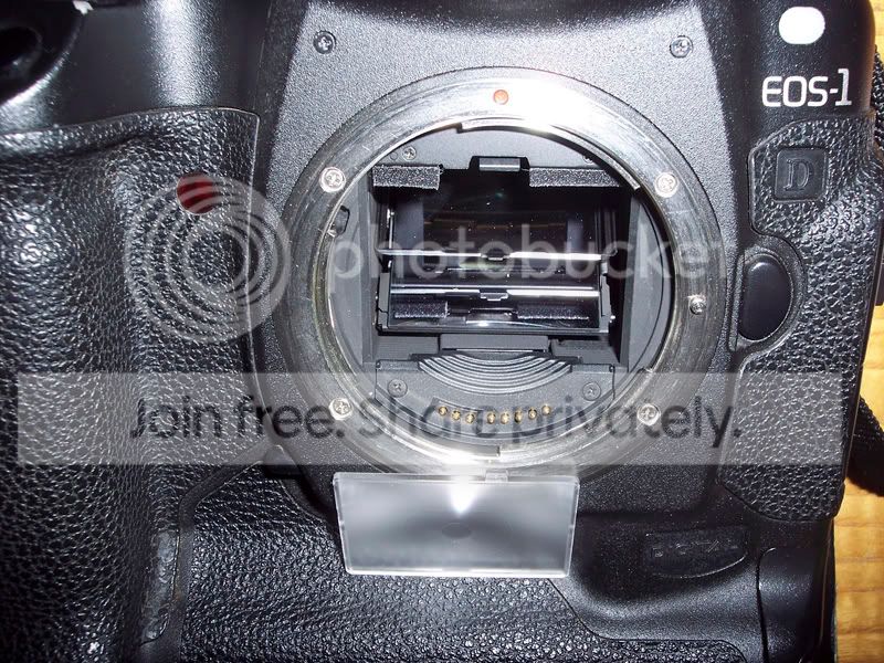

I've won an auction on this camera but on receiving today and opening the lens cap to check the mirrors/shutter etc, this opague plastic square which resembles an af hud fell out. photo's below.:'(
I'm really not experienced at all with the components of a 1dmki but if there is anyone who can help or advise I would be most grateful.
We got this at a great price but the item description said it was in full working order.
The kind of questions I have at this time are:
How bad is it?
Should I return the item?
Does it need to be repaired? Can it be repaired? How much would a repair be roughly?
Looking forward to hearing form someone very much :'(

Don't panic! It looks like the interchangeable focus screen to me. In the first pic, you can see the frame that holds it in place has come loose.
Check the manual about changing screens and it will show you how to pop it back.
1D has an interchangeable focussing screen. Pop it back in and you "should" be fine I think.
If its like the 5D then they're meant to come out. Try putting it back in.
Thomas,
That is the focussing screen. They are detachable and can be changed for different versions if required.
I have to shoot out for a while but can send re-fitting instructions in an hour or so. There shouldn't be any problems refitting it and you can test the camera without it installed to make sure it hasn't damaged the sensor whilts it was loose. Also checkout for a small brass/anodised frame that fits around it.

Give the screen and the bottom of the pentaprism a good clean with a blower before you reassemble it. you don't want dust in the viewfinder. It doesn't do any damage but it is annoying

One thing I will mention is be very careful with handling the focussing screen and hold it by the edges. They scratch easilly and cleaning fingerprints off is a good way to do that. :)
