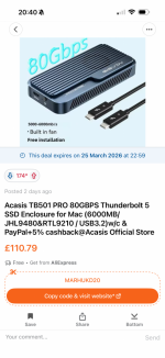

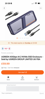

This TB4 enclosure is reasonably priced. I have the TB5 version and it works great.
This TB5 enclosure is an absolute bargain but I haven’t personally used this brand. It’s twice the price on Amazon.
