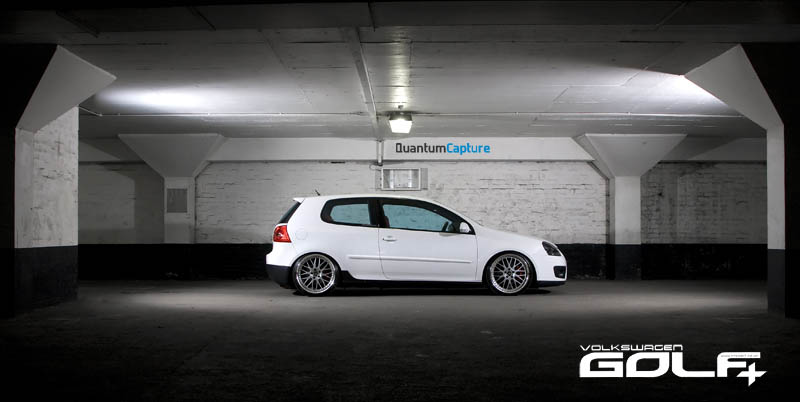

if you're shooting in a car park or somewhere with a ceiling then you can bounce off of that, it will help. To be honest I gave up on the endless fiddling with umpteen flashes and have gone for a portable lighting system.
A Diffuser helps but you need to up the output of the flash in order to get enough light when using a diff, which then means batteries get eaten quickly.
This was taken with 3 speedlites, 2 diffused roughly 2 meters apart, one firing up at the rear, one firing down to the side and the other up to the side/ceiling, and to be honest, it's still a little dark

you can also make specific shots for each part of the car and then blend together. 3 speedlights should be enough to light a car but with flash you are pretty much going to get hotspots. I use bare lights to light my shots although I know a few people that use brollys.
this was shot with 2 portable flashes and a speedlite
this was shot with two studio lights
