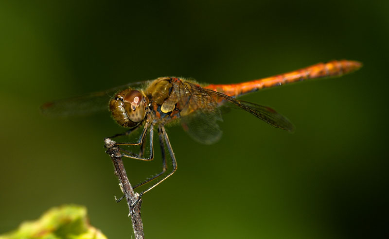

I use an extension tube + TC as a sort of macro at times:
Doesn't help as much on long lenses as you tend to need a LOT of extension, the longer the lens, but you can shave off a few inches from most lenses with one. I use Kenko - cheap but they work :)
Blimey - what combination did you use for that? How far away was the lens and didn't you spook it?
Nikkor 300mm f/4 AF-S with 1.4x Kenko Pro 300 DG + a 36mm Kenko tube.
I was under 1 meter.
