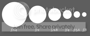

As a diagram, it would look like this

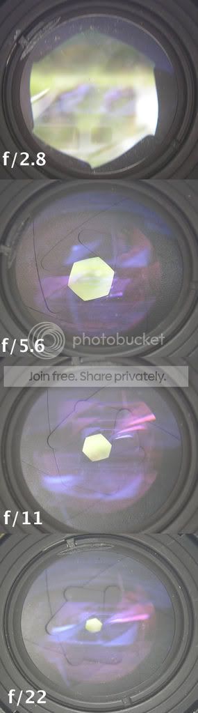

Here are some images of a real camera lens showing the aperture blades in action at various settings.

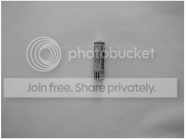

To better understand what a light meter does, here's an example.

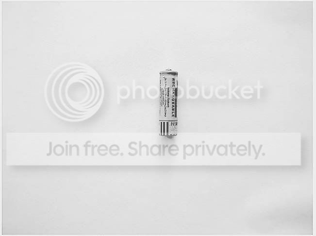

Here's a shot of a battery sitting on a piece of white paper.
I've reduced the image to greyscale so you can more easily see what's going on here.
As you can see, it's a mid tone battery on a white piece of paper as it should be. Want to see what a camera's auto exposure did to it?
Set to auto exposure the camera produced this.
Why? Because your camera's meter takes an average reading of the whole frame and determines an exposure value that will render it a mid tone.. usually 18% grey. It does this because most outdoor scenes with a range of tones from light to dark can be well exposed by doing this. However, when the background forms the majority of the frame, as you can see, it fails.

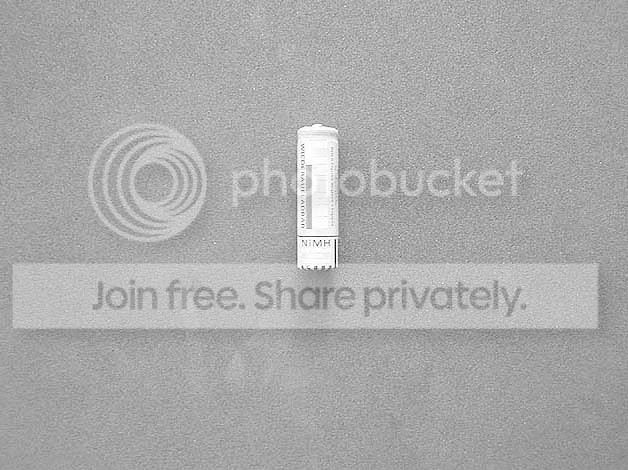

To further illustrate my point, i placed the battery on a black piece of paper, and this is what the camera did.
You'll notice that the paper has been rendered exactly the same shade of grey as the previous pic, yet in reality, one was white, and the other black. Because of this, it's the battery that's been wrongly exposed, not the paper. (none of these images have been corrected in photoshop etc)

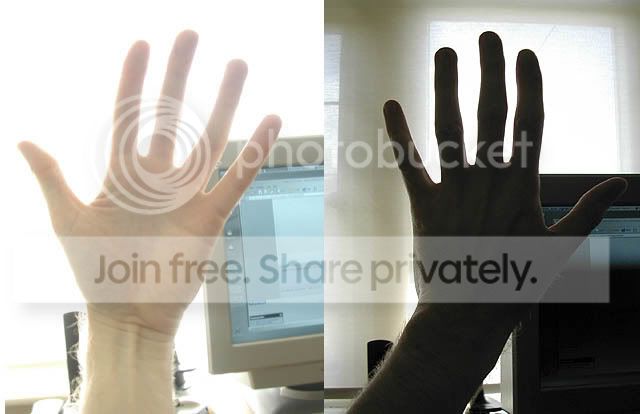

To transfer this example to real life: You're probably more familiar to a scene like this.
I held my hand up against the window, and photographed it.
As you can see the one on the right is what resulted. The meter was fooled into thinking it was the background I wanted correctly exposing, because that was the largest area of the image, and being the brightest forced the camera to expose for that. The result is a dark hand. Why? Because the background was so much lighter than my hand. It's tried to average out everything to 18% grey.
On the left is a correct exposure for the hand.. on the right is how most auto exposure modes will render the scene if left on Auto.

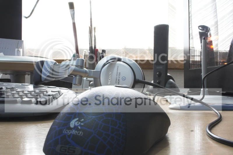

Here's an example.

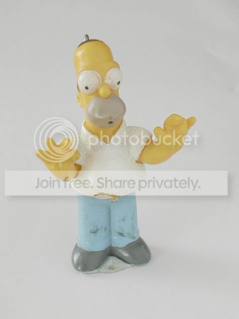

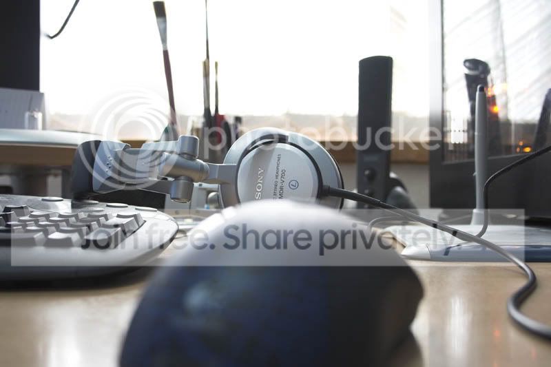

In the first shot, the shutter speed was 1/4 sec with an aperture of f4, and it gives this result.

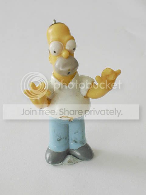

Here's the second shot. As we learned earlier, using reciprocity, we can also use 4 seconds at f22 (remember you can go past 1 second as well, and then it becomes 2 secs, 4 secs, 8 secs and so on)... so that's what I used: 4 seconds @ f22
As you can see, the exposure is pretty much teh same.. it's no lighter, or darker. However, look closely.. you'll see some rather striking differences.
In the first shot, the only thing in focus is the pair of headphones, because that's what I focused on. The speaker behind, and the mouse in front, are soft and out of focus.
Now look at shot 2. While still not in razor sharp focus, you can see that the whole shot, from front to back is almost completely sharp.
This is depth of field in action, and it's a direct result of aperture.

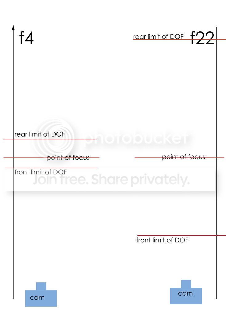

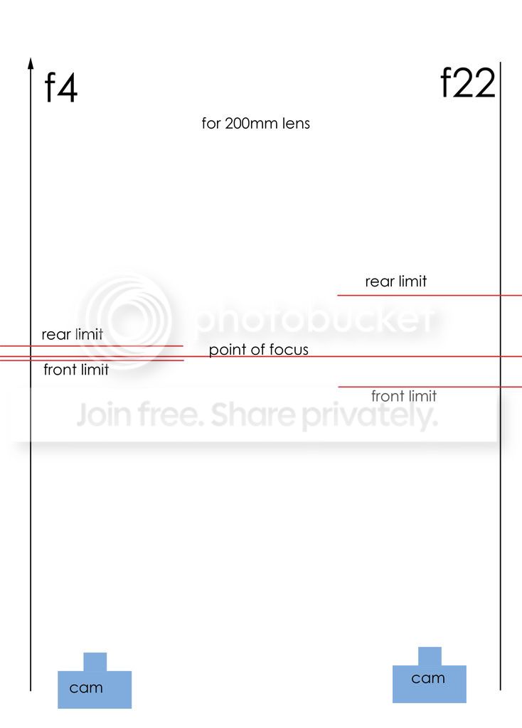

Here's a diagram to illustrate.
As you can see, as we stop the lens down to a smaller aperture (bigger number) the area behind and in front of the object we focused on also starts to come into focus. In reality, only the actual point we focus on is ever in sharp focus, but the area of acceptably sharp focus is greatly increased.
You'll also notice that the area of sharpness behind teh object in focus is always greater than that in front. This stands true for all lenses and apertures: There's always more depth of field behind teh object than in front.
The focal length of the lens itself plays a big part too. Wider lenses (shorter focal length) lenses display more depth of field than longer ones. In reality, they don't, but due to magnification, the visible results give the impression of more depth of field, and that's all we're bothered about in this article. For example, the diagram above is for a 18mm lens. If we were to use a 200mm lens for the same aperture, the diagram would look more like this.
Obviously the objects concerned will be further away, as that's when we generally need to use a longer lens, but relatively, the depth of field is compressed, and not as deep with a longer lens.

Because all of the objects were fairly far away, depth of field was not an issue, but were there any objects close to the camera, they would have been out of focus in shot1 but much sharper in shot 2. Why is this? Because shot 1’s shorter shutter speed required a wider aperture, and wider apertures give a shallower depth of field. In fact, in shot 2, you can start to see the rain on my window as the depth of field is now so much deeper. In shot one, the fast shutter speed required a much wider aperture, and the shallow depth of field blurred out the rain on the window entirely. Shot 2 uses a smaller aperture, and the greater depth of field is now starting to render the rain sharp enough to see.
So.. armed with this info, we can now work what shutter speed we need for any given situation. Cars need fast shutter speeds if they’re moving, right? Well… yes, but only if you WANT them to be frozen. With a moving car, it is often desirable to convey movement, and freezing it entirely just makes it look static. For all you know I could have lied and the car in shot 1 wasn’t moving. It was of course, but you can’t really tell.

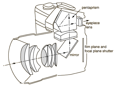

Why a SLR?
Simple. SLR stands for single lens reflex. It's a system that allows you to look through the same lens that takes the photograph, rather than a separate viewfinder. This means that what you see, is what you get (in terms of framing the shot). Very high end pro cameras will show 100% of the frame, but cheaper cameras will show around 92%, but this is still enough to accurately frame a shot.
Here's a diagram to explain
That mirror is usually in the down position you see above. This directs the image being focused by the lens onto the focusing screen, then through the prism to the eyepiece. WHen you press the shutter, the mirror flips out of the way and the very same image is then focused upon the film. The mirror flips back down. All this happens in a fraction of a second, and even with your eye to the camera you barely see the viewfinder go dark.
ALso, exposure information will relayed to you in the viewfinder so you wont have to take your eyes away from the camera.
THey also allow you to change lenses to give you even more flexibility and scope when it comes to creating the exact shot you need.

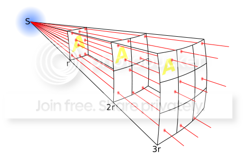

Inverse Square Law!
Oh God, another law, and more maths? Afraid so, but stick with it, because once you understand this, you'll probably never use on camera flash again unless it's just for a snap shot at a party etc... or for fill-in in high contrast situations (see further down in Daylight Flash)
To understand this fully, you have to get your head around the fact that light is just another form of radiation, like heat, radio waves etc. In fact, it's all part of the same thing: The Electro-Magnetic spectrum.
I won't put you to sleep with the actual formula but to sum up Inverse Square Law says:
The intensity of light radiating from a point source is inversely proportional to the square of the distance from the source. Got that? No? This may help.
So as you can see, with a point light source, if you double the distance, you quarter the intensity. In short, if you take a photo of someone 4 feet away, and 4 feet behind them is a wall, then the wall will be 4 stops under-exposed even though it's only a further 4 feet back. This is why your flash shots taken at parties and night clubs where it's dark, always have black, or very dark backgrounds. By the time the light has reached the objects behind it's fallen off so badly it's no longer sufficient to give a decent exposure.
Well.. the sun is also a point light source, so how come I don't get black backgrounds during the day? That's because the sun is 93 million miles away and the difference between you and the background can be measured in feet, so when the light has already travelled 93 million miles, a few more feet makes no difference. Look at the above diagram: It's the density of the lines of radiation that determines intensity, so the nearer you are, the greater the fall-off. Look at the diagram again. Twice as far is ¼ intensity, but twice as far again is not 8 times less; it's 6.. twice as far again will not be 16, it will be 12 and so on. The further away, the less the difference. It's INVERSELY proportional to the square of the distance.
Even if the maths baffles you, just remember this. The nearer you are to the light source, the greater the fall off.

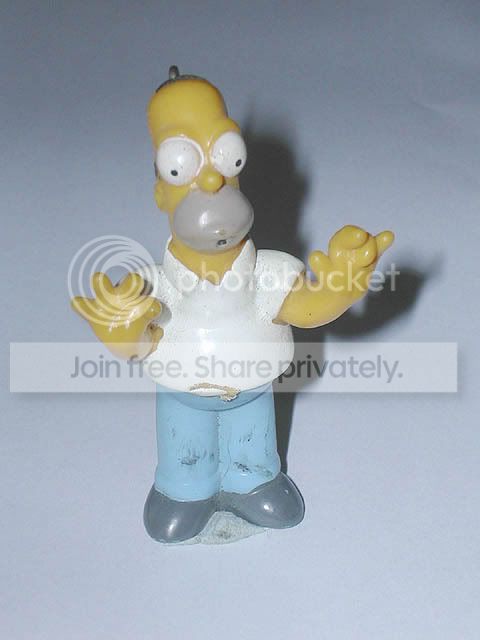

So what does this mean in reality? As usual, I've used props that are within arm's reach to demonstrate :)
Shot 1 is taken with on-camera flash. Shot 2 is taken with daylight from a window. Both Homers were placed on the same piece of white paper.
You can clearly see Inverse Square Law in action. In the flash shot, even though the distance from front to back is only a few inches you can see the light falling off towards the back of the paper. The daylight shot doesn't suffer noticeably from this, because 1) the window is a larger light source (in my case about 4ft by 5ft) and 2) it's further away. This is why a professional photo studio will use umbrellas or big soft boxes on the lights; to make them larger. They will also use much more powerful lights that allow you to place them further away.
Remember, the further away, and larger the light source, the less the fall off in intensity with distance.
Shadows are also a problem with small lights near the camera. Because the light is radiating out from a single point (the camera) shadows are cast almost equally in all directions, so you get deep, unflattering shadows everywhere.
