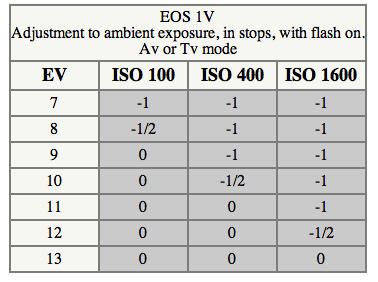

Phil, unless Canon altered the logic for eTTL in mirrorless (vs. dSLR) there is no differentiation in the Canon logic of 'flash for fill' vs. 'flash for primary illumination'...there is only a SINGLE logic I did extensive testing of Canon dSLR flash logic over a decade ago proving that flash intensity did NOT vary based upon which of the the various shooting modes (P vs. Av vs. Tv vs. M) was being used during eTTL flash exposure. In my testing, I found that the amount of flash emitted DID NOT VARY, switching the camera between modes.
There can be variation in flash intensity at certain EV levels of ambient light. In light levels below EV13 and varying dependent upon specific EV level, NEVEC (Negative Evaluative Exposure Compensation) begins to kick in and pulls ambient-to- fill ratios out of whack, regardless of exposure automation mode! The amount of alteration is EV-specific, so it can be challenging for a pro to even know in advance how the ambient-to-fill ratio will be altered, without first measuring ambient EV level and then also consulting a table! NEVEC existence has been around since the days of the EOS film line, as reflected in the label of this chart. Note that Av mode behavior is identical to Tv mode behavior, in this characteristic. Notice also that the degree of variation is ISO-dependent! Canon knows how to screw with pros' heads, since they would want to control fill ratios (whereas the typical snapshooter is hardly aware of the significance of fill ratio control.
Additionally Canon screws with our heads by the inclusion of AFR (Automatic Flash Reduction), also EV-dependent and NOT exposure automation mode dependency. AFR is not camera mode dependent, it is solely based on ambient EV level. Some Canon models can disable AFR, but not all. I compiled this table many years ago.
Unfortunately, the demise of certain photography forums is cause of the disappearance of this combined insight in the photographic knowledge base.
Additionally Canon screws with our heads by the inclusion of AFR (Automatic Flash Reductinon), also EV-dependent and NOT exposure automation mode dependency. AFR. It is not camera mode dependant, it is strictly baed on ambient EV. And SOME Canon models can disable AFR, but not all. I compiled this table many years ago.

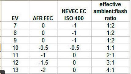

So - as per the original issue, NEVEC is programmed for less than what the ambient is set at. So if the ambient is 3 stops under, the flash will be roughly 4 stops under.
Which is exactly what I've been saying.
I didn't have the tables, but knew that I'd red it somewhere.
The key point for all is that flash reduction 'for fill' is
  1. not dependent alone on Tv vs. AV (they act the same!), although NEVEC does treat both differentnly from P or M
  2. dependent upon ISO and ambient light level
  3. and there is no deliberately selectable 'fill mode' per se vs 'primary illumination mode' (but there is hidden behavior not well documented, as discussed in #1 and #2(
So 'fill mode' or NEVEC or AFR would not explain OP issue of -2EV or -3EV underexposure...most Canon shooters have tons of snapshots using eTTL flash which is the primary source of illumination, correctly exposed. Why the R5 for the OP would behave any different is the puzzler.
