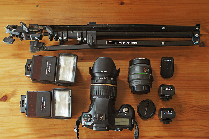

This was my set up when I started dabbling in flash photography. Not pictured, a second lightstand, a tripod for the camera and 2 x white brollies. I reckon I could have approximated the look of those shots reasonably well. (I note they haven't eliminated shadows entirely, which would probably require a third flash on the background). The flashes here are about the cheapest you can find with manual flash level settings (which is kind of all you need in terms of technical sophistication). The little black things are a cheap £10 chinese radio transmitter and receiver to trigger the flashes off camera. Not the most pro-looking set up though ;) I'm not suggesting you need to be as miserly as this, I'm just showing the absolute minimum you can get away with, and that you don't have to spend exorbitant amounts of money.
