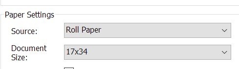

Printing from LR is fairly simple. I was making a 12x34 inch print (6x17 neg) so I had to set up a custom paper size. Epson print driver happiness time as the custom print size isn't recognised. The steps...
In LR, click Page Setup. When the print driver pop up appears, choose properties.
Under Document Size, click "User Defined"
In here, create the full size canvas you want to print on. I wanted 12 x 34 on a 17" roll, so set the "canvas" to 17x34. Save it as a prest if you're likely to use it again.
Click save
If you've done it right, you'll see your new canvas here...
Problem is that when you then click "OK", you get pushed back to the original pop up and the settings haven't taken...
If you try to choose your setting from the size dropdown you'll notice it's not there. In order to get it to show you need to completely cancel the print and start again. It must need to "turn on and off" before it works...
From there, you'll see the LR canvas change to your new size and you're away.
