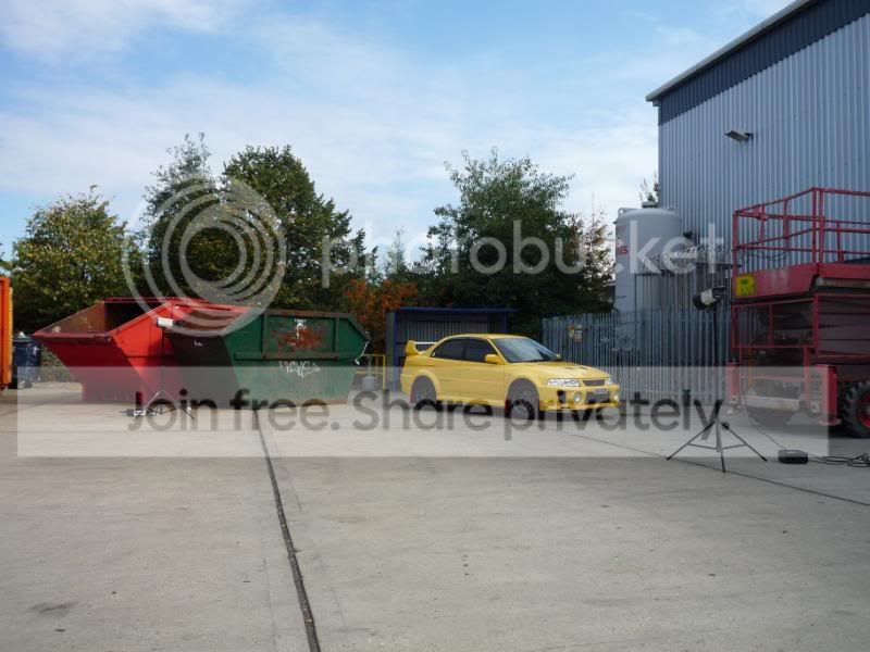

What is the yellow Evo shot telling us?
just a shot of the system being used + lack of ig softboxes
and as to why ive been swaying away from a single big battery, when for similar money you can get 2quadras..
