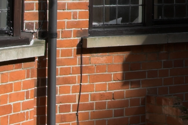

Here are two straight comparison shots. Both are 100% crops and taken straight from the RAW file with no processing. I set up the 20D on a tripod with the 16-35mm attached. Framed the shot. Autofocused. Set the aperture and shutter speed manually. Took the shot in self-timer mode. Changed the lenses. Autofocused again and took the second shot. The camera wasn't moved and the settings weren't changed between shots.
18-55mm @ 24mm, f/8, 1/80s, ISO 100:
16-35mm @ 24mm, f/8, 1/80s, ISO 100:
If I'm missing something please point it out but those two look hardly any different to me apart from a bit of difference in the distortion. But the sharpness seems to be remarkably similar.

Enjoyed reading the write up Jamie. If anything, on my monitor, I think the 16-35 just has an edge on sharpness. However, I would agree that 750-900 oncers is a lot mullah for a little difference.
regards
Fingerz, I'm not going to argue with you on value for money.
The kit lens is exactly that, value for money.
With the 20D crop factor and shooting at f8 the kit lens puts up a good show against the 16-35. But these two lenses were developed for different types of cameras. Most lenses will perform well at f8 and at the center of the frame ( i.e. your 100% crop). Where the money comes into it is wide open and at the edge of the frame. Bear in mind the 16-35 will perform well on a full frame camera as well as a 1.6 crop.

Oh yeah... Don't get me wrong. I can see a tiny bit of difference here too. But make no mistake, it is tiny. I enjoyed using the lens but I shan't be investing until I know enough to work out why I can't see much difference.

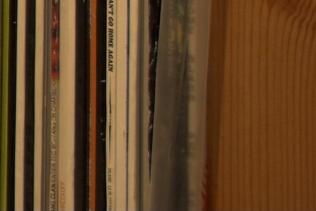

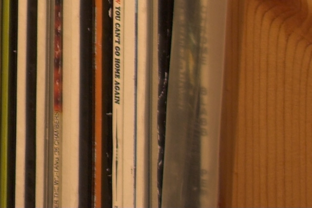

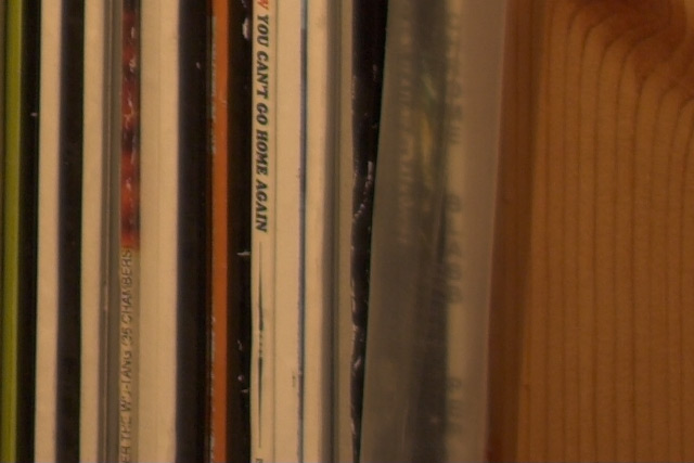

Right, these are all 100% crops taken from the bottom right corner of the frame. I know they're not totally identical frame-wise. I think it's because it's hard to get the focal length exactly the same. Also when dealing with corners of an image I guess the distortion thing comes into effect. Anyway here you go. I've included the 16-35mm at both f/3.5 and f/2.8 as I didn't know whether you wanted a like-for-like comparison or a properly wide open comparison so I did both.
18-55mm @ 24mm, f/3.5:
16-35mm @24mm, f/3.5:
16-35mm @24mm, f/2.8:
I think the f/2.8 one looks slightly brighter just because I was changing shutter speeds to compensate for the shots at different apertures and I must've gone a click too far or something.

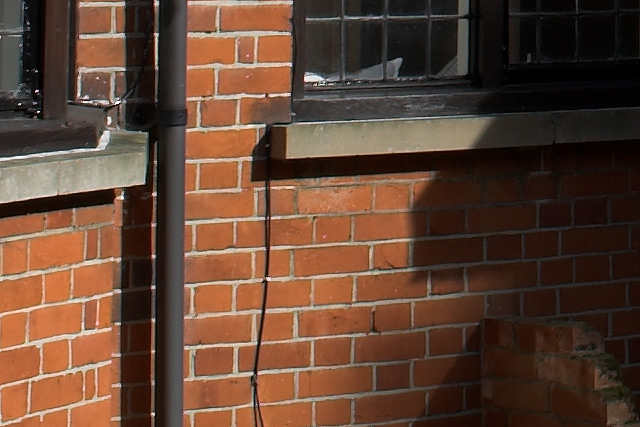

Ok, this probably isn't what you meant but I re-did the two shots of the house and this time I gave the images an unsharp mask using exactly the same settings for both pics. It begins to become more apparent that the 16-35 is sharper. It's not a small difference but it's not a huge one either. And bear in mind we're looking at a 100% crop and talking about a good £700 price difference at least.
18-55:
16-35:
That's a better test by far Jamey. I see a huge difference there now mate to be honest. You'd really see the difference in making large prints from the two lenses, much more so than viewing the pics on a monitor. The other thing is that the image contrast in the dearer lens is miles better, no doubt due to superior glass and better lens coatings. Just look at the difference in the visble shadow detail on the right of the shots!

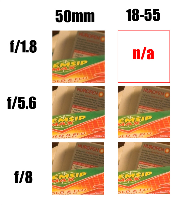

Here's a quick comparison I just did with the 50mm f/1.8 against the kit lens. They're 100% centre crops. Don't have time to do corner crops right now. For some reason the camera metered about 1.6 stops darker with the kit lens on (no, I didn't have a CPF attached, before you ask) so I boosted the exposure of the RAW files for the kit lens shots by 1.6 stops to compensate.
