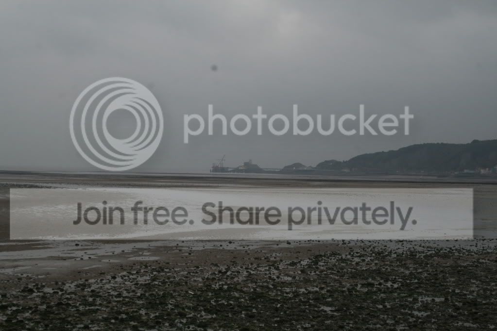

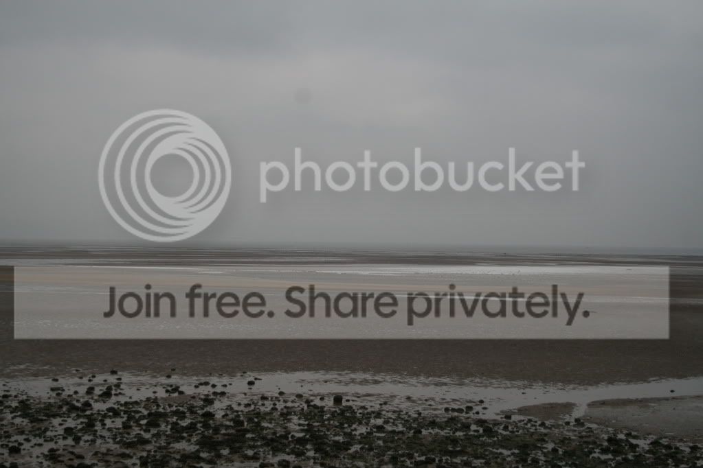

Anyway as I was flicking through the pictures I noticed on one picture of the bay a very noticeable dust spot which is less visible on other photos and sometimes non-existent on others.
Bad Photo
Not so bad photo

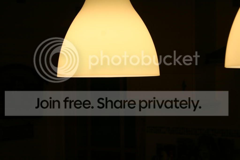

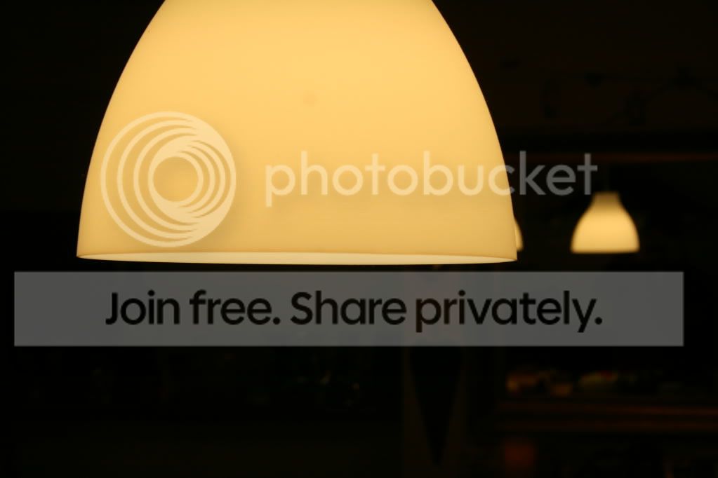

I tried brushing the mirror and using a blower but no results so I used the "dust delete data" and from taking some pictures of a bright light, the dust is visible in the viewfinder but gone in the pictures.
Test shot #1
Test shot #2
Hopefully the Dust Delete Data will keep the problem at bay but would you recommend getting a professional sensor clean if it returns, as you can see its a large spec, my father said it was a UFO and asked whether it was possible to return the camera but I don't think I have a leg to stand on as it was second hand.

Its just dust on the sensor - if you look closely at the first photo there are quite a few specks. Its to be expected on a DSLR.
You can get a sensor clean or you can easily do it yourself. First time it can be a bit buttock clenching but its easy to do.
Quick edit to show most of them - not easy with dust on a grey background

And to go a little further while I've not checked the exif you will find that dust spot's will be a lot more visible when your shooting at smaller apertures :thumbs:
Just to add to what Matthew said, the specks you see in the viewfinder are insignificant and won't appear on images.
Smaller apertures means higher f/numbers. They're best avoided anyway as diffraction reduces sharpness, noticeable at anything higher than f/11.
I have no clue what aperture was used I had the camera on P. So just forget about the dust then seen as the "Dust Delete System" seems to have dealt with it (I think it has but then again I didn't see all those dust spots on the photo of the bay only the really bad one, my eyesight isn't very good even with my glasses) or should I get it cleaned for a fresh start or 'could' I send it back?
EDIT: the Dusty photo was shot @ F11 and speed 1/250, the second bay photo was F6.3 and 1/1000. I used a blower on the sensor, and I erased the "Dust Delete Data", I set my aperture to 22 and shot a white computer screen (saw a guide on web to seeing dust) and the biggest UFO is still there, so is a proper clean the only step to go now?
