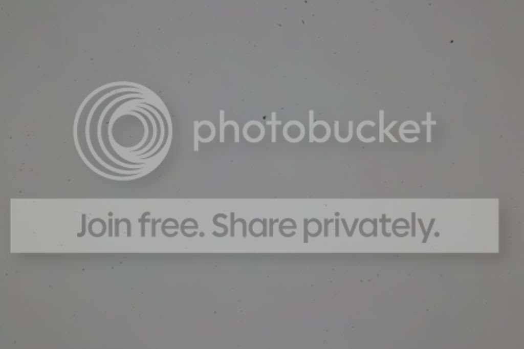

I just followed a tutorial online and took a pic of a white screen (windows notepad) up close, the result is really depressing - LOADS of marks unfortunately :( See below. This really needs to be sorted :( Is there a recommended cleaning kit to get (something that won't break the bank ideally)?
You can't see the sensor through the viewfinder, so that's a separate issue, most likely dust on the mirror or focus screen, maybe in the viewfinder itself.
Get yourself a rocket blower and give it a good blow, then get a visible dust swab kit and give the sensor a clean. Don't shoot at such high apertures, f/11 is plenty for almost all situations.

Well my rocket blower arrived yesterday. Gave it a go last night, but it seems to have made no difference at all.
Just to make sure I'm doing this right - I set the camera to Sensor clean mode (I'm on an EOS 20D), which seems to open up the section behind where the lens attaches (sorry, still learning all the terminology!), and then gave several good blows into the space there.
I then took another test pic, and it doesn't seem to have made any difference at all.
Is the next option a wet clean with eclipse fluid and swabs? Do I do that in the same way - i.e Sensor clean mode and then use the fluid/swabs on the mirror/sensor?

Sounds about right Sean, always hold the camera upside down so any dislodged crud falls out. Give it a good few puffs of air with the blower pointed at, but not touching the sensor (flat bit at the back of the opening)
Same again if you use swabs and eclipse, most important couple of drops on the swab and leave it for 10-15 secs before using.
My guess is that the dust is so old that it has been fused onto the sensor over time (by absorption of moisture from the atmosphere turning it into a mini-mud) and that a mere puff of air won't fix it. That does mean getting more physical with fluid and swabs.
The technique with the camera will be the same - set it to sensor cleaning mode, which will raise the mirror and open the shutter curtains. Make sure the battery is well charged before you start. If you have a tripod you may find it helpful to mount the camera on that so that you can position it firmly at exactly the right angle and keep it absolutely still while you carefully wipe the sensor. You may find that it will need a few tries to soften the muck and allow it to finally be lifted off. Be wary of re-using the same swab for repeated wipes. Once the muck is on the swab you don't want to be scraping it back and forth over the sensor, in case it is gritty and might cause a scratch. A few swabs will be far cheaper to replace than a ruined AA filter.

Worth noting as well, when hunting for that last elusive piece of dust, that the sensor image is fully reversed when it gets turned into a photo, so a piece of dust which appears in the top right of the photo would actually be found on the bottom left of the sensor etc..
Is that right?
I'm pretty sure it's just top becomes bottom and bottom becomes top. Right and left stay the same, so a mark on the image in the top right would be on the bottom right of the sensor. As you look at it.
Is that right?
Yes, as Alan says.
It's confusing because you're looking directly at the front of the sensor, and not through it from behind - if that makes sense :D
