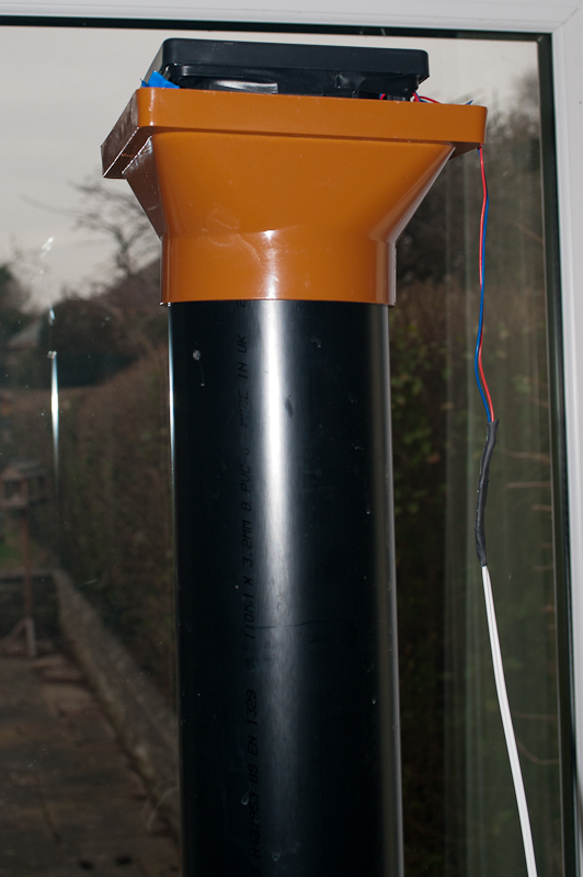

Top part of pipe with square section and fan mounted. You can just make out the aluminium rod on the upper left of the black waste pipe (it's level with the top of the flash reflection in the door)

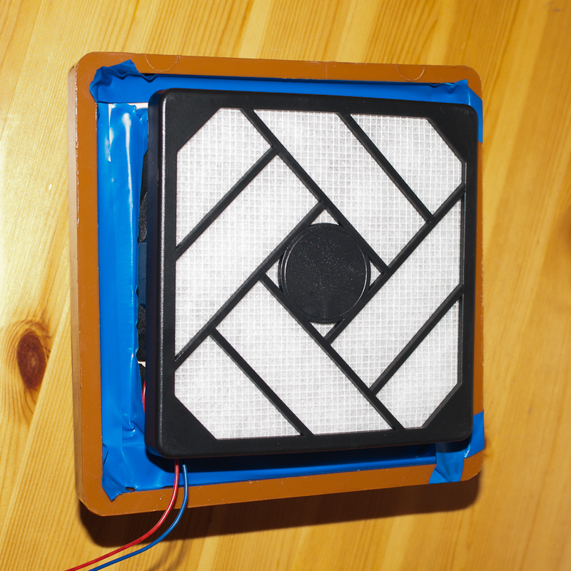

Top view of fan unit showing mounted air filter

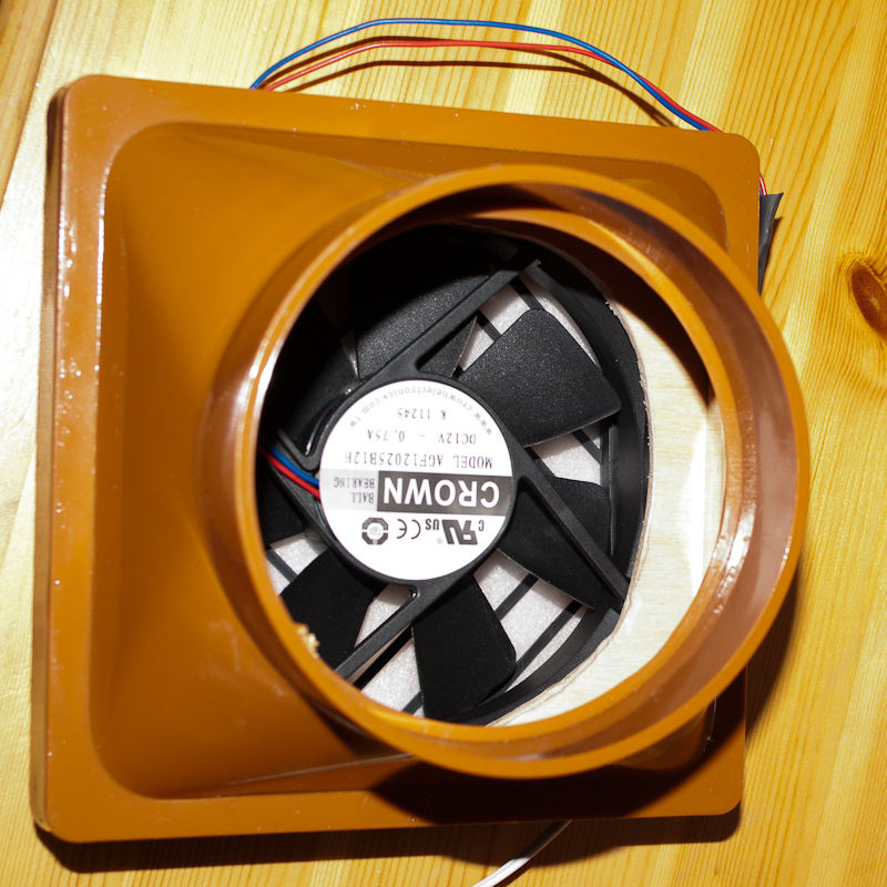

View from bottom of fan unit showing fan and simple ply mount
