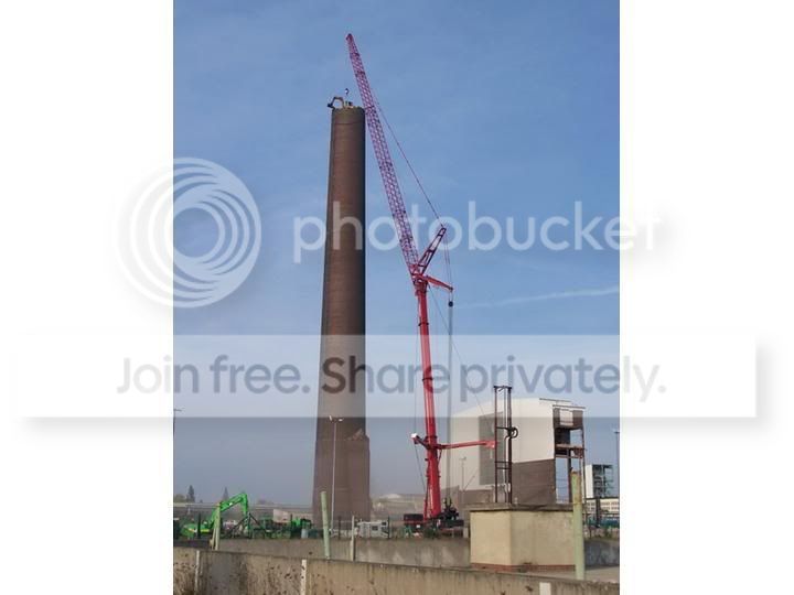

Does this look like a sensible way to demolish a chimney

There's a truck inside the chimney the bricks land in the back, I never found out where it was in the world, not in western europe i'd imagine :rules:

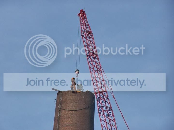

Love to hear a cranedriver/rigger/slinger opinion on this one:eek:
Looks like some crazy one off idea from someone who thinks they know better than anyone because they are in charge:eek:.
I would wager it went over budget.
Whats most worrying to me is that there is what looks like a ladder up the side of it :cuckoo:
You think thats worrying, wait till you see a re-run of Fred Dibnah putting up ladders like that. ...strap the first on, then climb it, and strap the second one one ...etc etc...hundreds of ladders later and Freds still climbing up with a new ladder on one shoulder, resting on the way to enjoy the view...

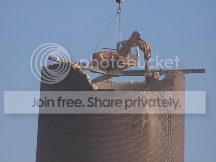

Part of my job involves me going to sites and advising them on crane lifts. The one in the shot I'm very glad I wasn't involved in! Bottom line is, the biggest problem is stabilising the excavator on the beams - they appear to have removed the bottom workings completely, and attached the rotating base directly to the beams, which would then allow the crane to take basically the full weight of the machine and beams. What is interesting is that the machine operator doesn't appear to be independantly secured in any way to the crane.......nor does there appear to be another crane standing by in case of rescue being required......

Robyn, doesn't the custom made framework appear to have been made from 3 identical telescopic crane jibs?.
The design of the frame does not look very substantial placing a lot of stress on the welded joints at the centre which is dependent on the skills of whoever welded it together:eek:.
