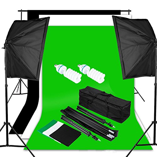

Morning all
Have been a lurker for several months and I really have learnt a lot. To start my photo study, first step is to grab some decent equipments. What kind of light modifier should I use? An umbrella or an softbox? What factors should I focus on when I buy them? I stumbled across one of these softbox, called excelvan, do them do the trick?
How to figure it out? Thanks for any thoughts from masses!
That kit is junk.
Start from the top.
What do you need to achieve?
What is your budget?
What experience do you have?
What kit do you already own?
That kit is junk.

Thanks for your inputs.
Personally, I'm partial to just using a big softbox for fill. But I shoot primarily small children, where I just want the fill light to look uniform and soft.
I have already got some cube kits and right now need to grab a modifier tool.
Budget is not really a issue actually. A good photo always needs the help of good tools. Does this softbox really a crap? Can you take a minute to look up this softbox? http://www.amazon.co.uk/Excelvan®-P...=sr_1_3?s=photo&ie=UTF8&qid=1457519782&sr=1-3
Or can you recommend some other softbox? Thanks anyway.
Cheap Continuous lighting is not the right tool for photographing people.
You'll get more bang for your buck with flash, and if you're serious you should start with the right tools.
A starter kit from any of the known flash brands will do the job, but IMHO Lencarta probably offer the best bang for your buck. Look at a Smartflash starter kit, you can build from there.
As phil mentions above, continuous lights are not an ideal solution for people photography - especially kids.
A good quality single studio strobe with a nice big modifier as your key light and big reflector as your fill will yield far better results than the continuous kit you are linking to on Amazon.

There are no right or wrong answers (except for continuous light kits, which are very much the wrong answer)
As other people have said, cheap hotshoe flashguns are perfect for carrying around with you and using in ad hoc situations, that's what they're designed for.
Some people also use them as studio lights, and up to a point that's OK if the objective is just to add enough light to take the shot, but they aren't suited for actually creating and controlling light, for a number of reasons
1. Limited power
2. Very slow recycling
3 No modelling lamp
4. Only work sort of adequately in small softboxes, not suited for large sofboxes and other modifiers because they have built in reflectors that stop them working efficiently.
So, if your emphasis is on studio work it's always better to buy a lighting kit designed for the purpose, and personally I recommend our SmartFlash kit with 1 umbrella and 1 softbox. There's nothing to stop you using a cheap hotshoe flash at the same time, if you want to use another light on an occasional basis.
I represent Lencarta, there are of course other makes available from other firms too.
