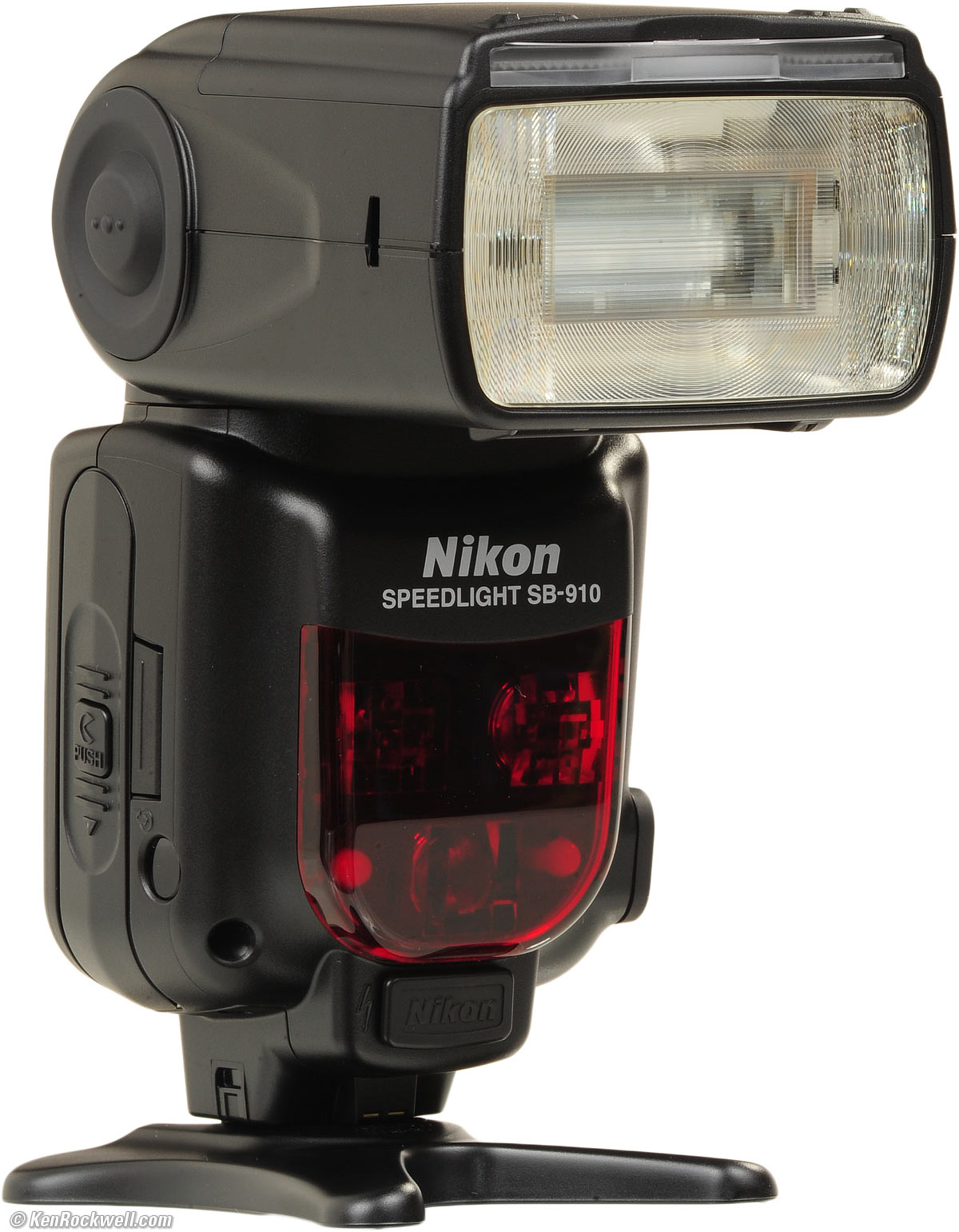

No, only top-end guns can act as commanders, and some of the pop-ups higher in the camera range. Most guns can act as remotes though, and they have a dark red plastic window on the front where the the receiver sits (in addition to the brighter red plastic AF-assist light) and that needs to get a decent 'look' at the commander unit, preferably line of sight.
Nikons use a small recessed black plastic disc window on the side of the flash by the battery case actually. It made the lack of full movement of the 800 head somewhat problematic, apparently (I'm a Canon user personally). Canons use front mounted red plastic receivers.
