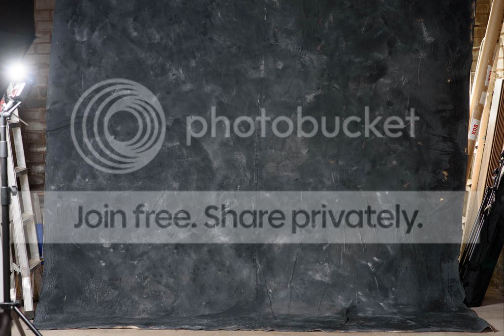

So I went back to check it today and it's actually not too bad. Another problem has arisen that I either didn't notice or didn't have at the start is that the canvas/cloth isn't rectangular its badly skewed so not all length is usable, I'll need to cut a bit off the top and bottom to square it up but at the moment I've just stapled it on a slant to a ceiling beam in the garage.
here it is...
Ok I take back the mean things I said about Sarah Oliphant their stuff is clearly a mile away in quality and look but lets be realistic for a minute. It doesn't look that bad imo and it was made in under 4 hours start to finish for under £35. I'm fairly confident MK II will go a lot better as I've Iearnt a lot from even this rushed job.
