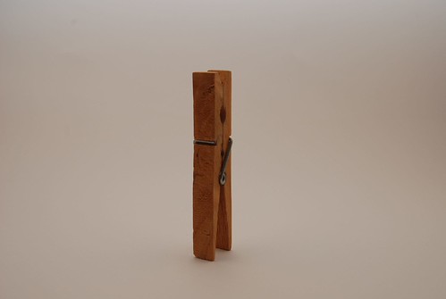

And finally an image from 'the studio'. I did put this through some photoshop, but awesome pictures come out if you just set the white balance to tungsten or similar on the camera. I also used an SB600 flash pointed at the "studio's" ceiling for this shot.

As promised, here's the original untouched photo the way it came out of my camera in jpeg.
And for the really interested, here's the picture in original size.
