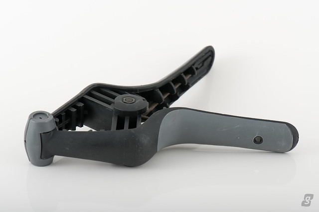

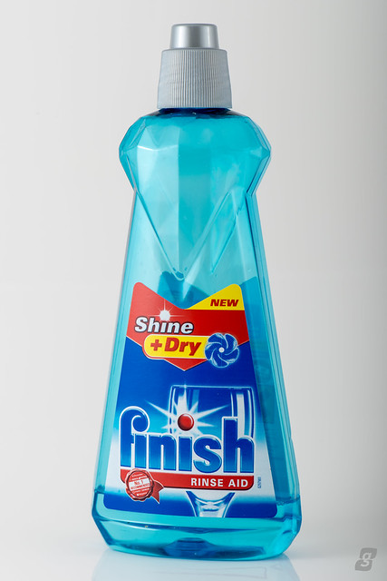

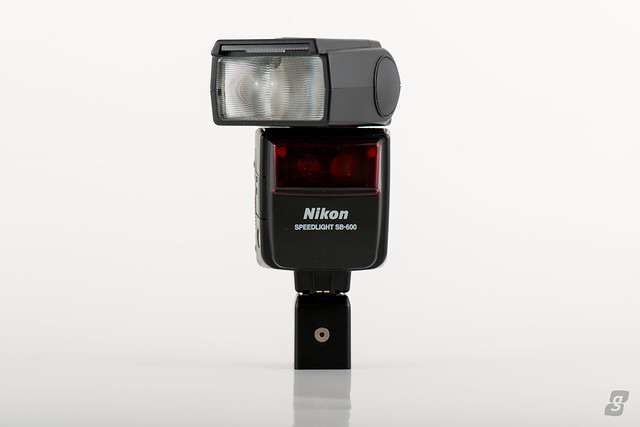

Here are a few test shots - nothing too glamorous!
1. Even powered
2. Left at 1/3 and right at 1/8
3. Even powered

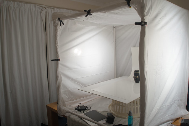

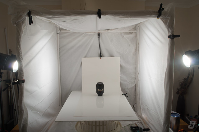

The setup using as best a pic as I could get, given the space I was in, is below...
4. Front View
5. Side View

Thanks Bob. This sort of thing would be perfect for product photography. The only downside going the DIY route is that it is not as portable/fold-away-able as the retail versions. A darn sight cheaper though! Well, at this size anyway...
The shiny background is two pieces of shiny paper that I got from the local art shop. The front one just goes over the back one where the little clamp is to complete the seamless look.

Can you tell me what lights those are that you are using,great result Graham.:thumbs:
Thanks James. These are Multiblitz Vari 5 lights. Love them but don't use them enough!
