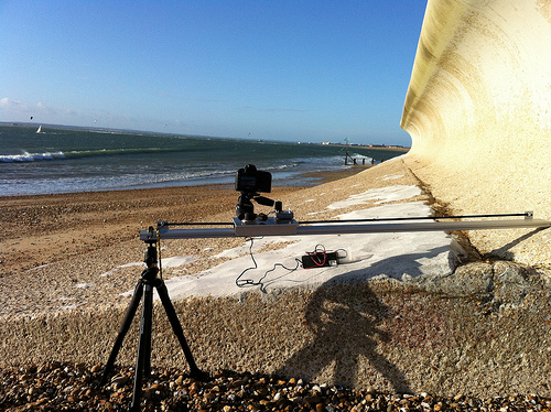

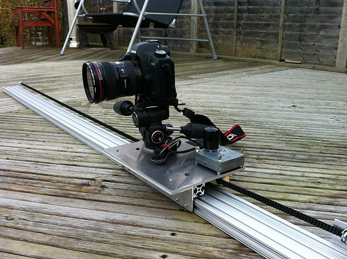

Here is the setup and a shot of it in action
Whats an "unscrew lens method", not heard of that
Mostly I fire a test shot in AV then change to Manual, the controller moves the cart then fires the camera,
Photoshop used to adjusts the curves etc on one frame, then Automate the same changes to the rest of the images
Movie then compiled in Premier Pro and Royalty free music added
I also have a telescope motor mount to track the skies which I hope to mount on to the cart for some night work
Vass

Don't suppose you have any more pics of the rig that moves on the rail? Are there wheels on it etc? I don't mind having a go at drawing up a template if I see some pics..

OK here is the final list folks, you have to do some of the work yourselves (its what I did!)
Motor and MX2 controller (kit) from DP
All Aluminiuim from the UK (Google it)
The 6 foot rail from Waterlooville URL: http://www.westgroup.co.uk
Pullys, belt, bolts, washers, screw, etc all sourced fom the web or local fixings suppliers.
thats it folks,
Good luck!
