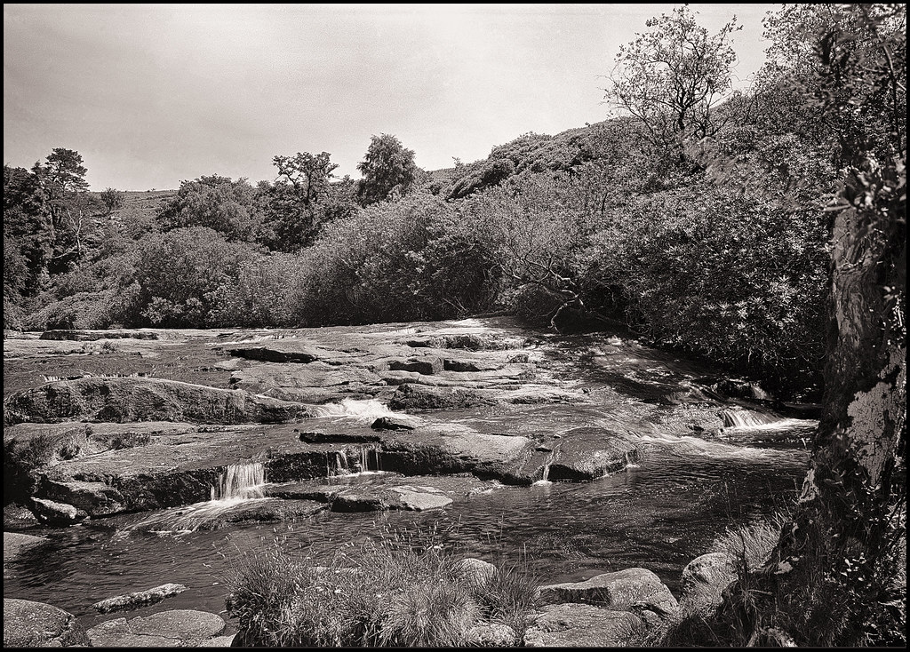

I used Divided Pyrocat HD as I wanted to see if the Compensatory Action would prevent the whites being completely blown out which is normally what happens with this type of image. This actually worked better than expected and I actually had to add a little contrast to give it a slight lift. In each case I metered using my Minolta Spotmeter F from the shadow area in which I wished to retain some detail and then closed down 3 stops from that to get my taking exposure.
5"x7" Fomapan 400 @ ISO250, 1/8 sec @ f32, Divided Pyrocat HD 6 minutes both solution A+B at 25° C. Wollensak WA Raptor 6.25inch f9 (80+ year old non-coated lens)
Steps, Avon River, Devon. by Ed Bray, on Flickr

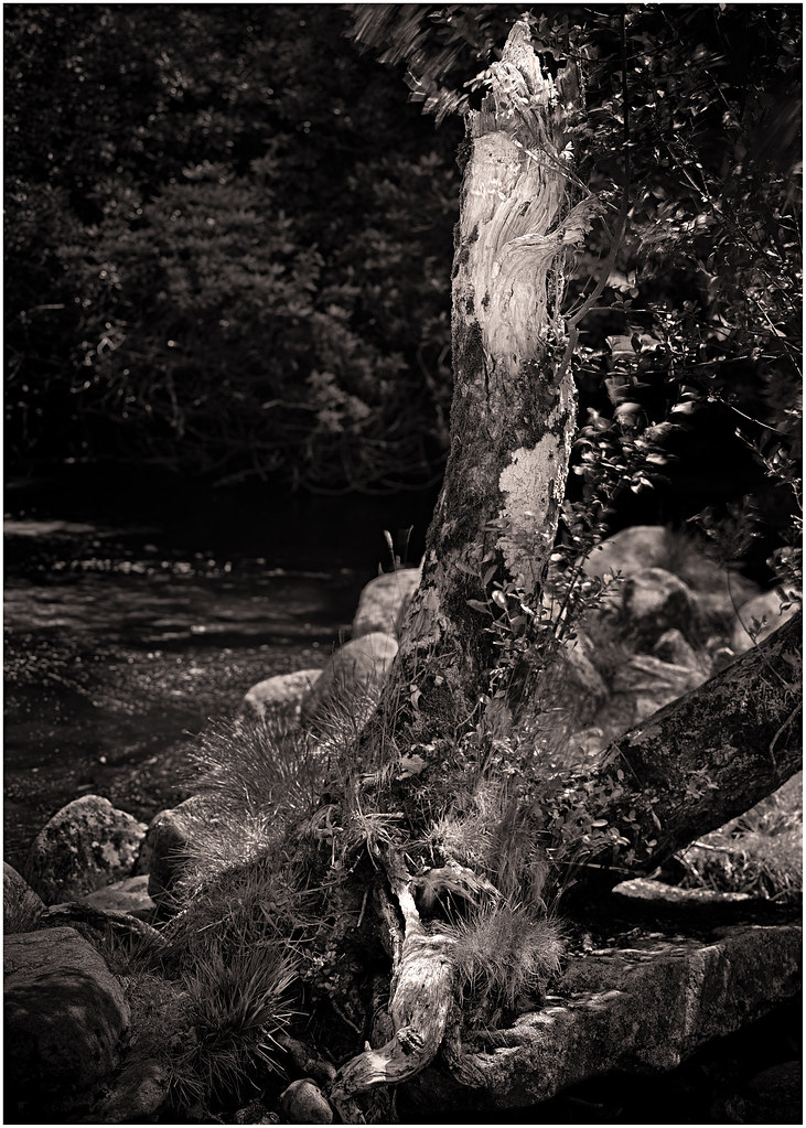

5"x7" Ilford FP4+ @ ISO100, 1/8 sec @ f22, Divided Pyrocat HD 6 minutes both solution A+B at 25° C. Schneider 121mm f8 Super Angulon Lens
Storm Damaged Tree, Avon River, Devon by Ed Bray, on Flickr
