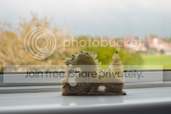

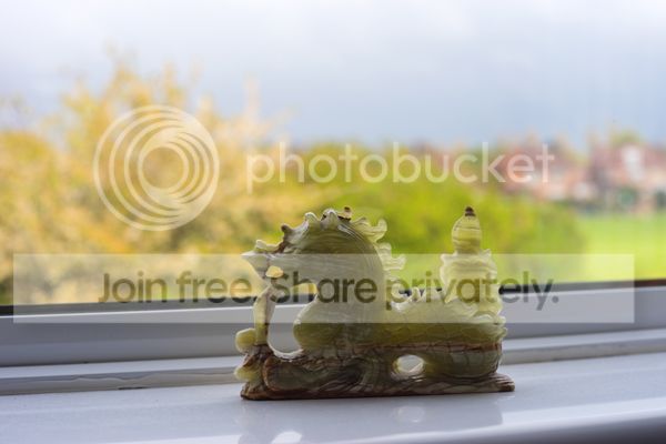

And to get back to the OP and the example images I posted...
When I took the FF shot at 50mm and f5.6 I had a good idea what the image would look like and I knew that to make a very similar image with the Panasonic G1 I needed to use a wide lens and a wider aperture, hence 24mm f2.8 on MFT = 50mm f5.6 on FF.
These two images will look very similar no matter what the output size and / or viewing distance until you go beyond what the hardware can do and print them the size of a barn by which time the G1 image will probably fall apart first.
