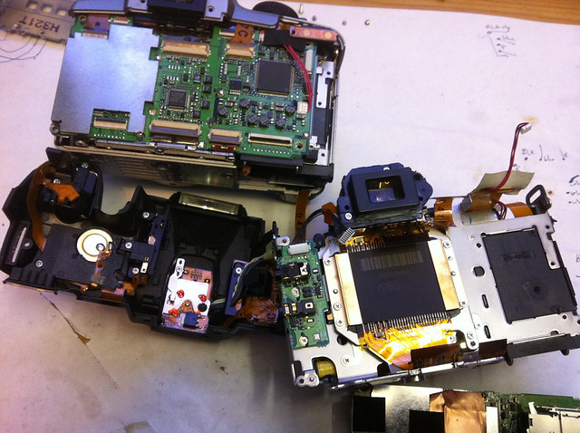

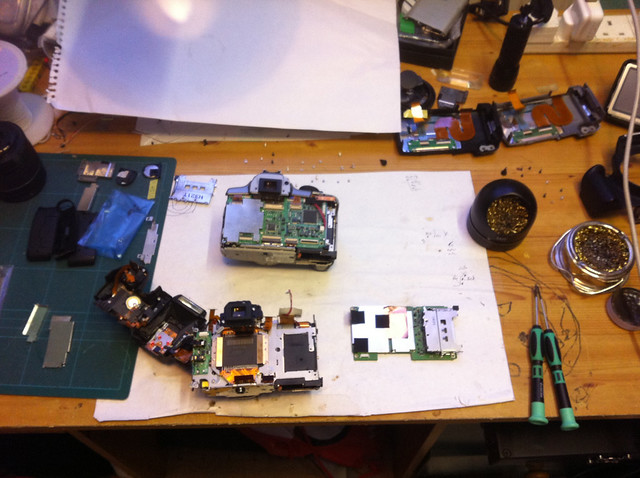

Actually heres a pic of afew open 350D's, ons having a shutter replaces and the other has a dead board.
If you are going to attempt it you will need a 0 phillips screwdriver, good light and a replacement filter, also some very thin washers.
The aim of the game is to take the back off, remove all the ribbons from the motherboard, remove motherboard, remove cmos assembly, remove old IR filter, calculate how much washers you will nedd based on the difference in thickness of the old filter and new optical glass, if you dont put optical glass in you will lose auto focus ability, put it all together and cross fingers before turning on.
