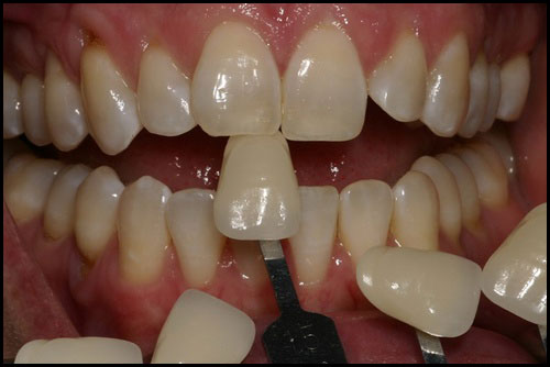

I am a dentist, and use a ring flashed camera to take photos of mouths. When we need to make crowns, we have our own shade guides, that are standardised by crown manufacturers. The problem is, when we have taken the photos, they are not accurate to the physical shade guide we have. Colleagues have told me that even when they calibrate their monitors, the photo they have taken is not accurate to the shade guide they have in their hands. We need the photos to be accurate so that we can send photos to the dental lab who also would have a matched calibrated monitor, so they can make a crown's shade accurately to the photo we have.
Using calibration hardware or software, would it be possible to calibrate monitors so that what I see is what appears in the monitor?
Here's a photo of a shade guide we might use:
How might I approach this?
Thanks in advance :)
One approach was to either calibrate monitors to the colour guides directly (if this is possible?) or to calibrate conventionally then use some sort of custom curve in photoshop to calibrate to the colour guide? (again, how would this be done?)
would the simple answer not be to photograph the teeth with the appropriate shade guide beside them? - or at least the closest matches?
like this?
like this?
Yes - that is an option - but if what you see on the screen is different from what you see in your hand, then you're still working 'relatively' - that is, that tooth is a bit redder, so I'll make the crown a bit redder - but not as accurate as comparing it directly.

Is the patient not able to make the decision which shade suites best by you holding the templates up against their teeth whilst they look in a mirror? Why do the lab need a picture :shrug: surely each template has a referrence #?
In a word, no. A photo is much better in explaining the subtle colour changes and characteristics of a tooth.
Just seems a bit odd to me as I have had three done and they all look fine to me. What I am trying to say is, if you look at the template yourself against the patients teeth can you not match it up :shrug: Going about it the way you are doing will surely complicate matters more, but then again knowing Dentists taking pictures is good enough to bung another fifty sobs on the bill :D
