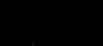

I was trying some long exposure last night and had the aperture at f22 and noticed loads of blobs on my photo, which i've never noticed before; This morning i've locked the mirror up and the sensor has huge water marks across the back of it (I can only assume from a previous bad cleaning job)
Will the usual sensor swabs/liquid shift these historic water marks? - You can see my dust ref image below; :oops: :$

Yes, give it a session with swabs / liquid. Have battery fully charged before you start (to keep the mirror up). Get suitably sized swabs & follow the instructions. Give a blast or three with a rocket blower first. And just take care, but it's easy!
Not sure an Arctic Butterfly would touch water marks. If you're not happy doing a wet clean yourself, take it to a reputable camera shop and get them to do it (then take a fresh dust reference shot before accepting it back!)

Cleaning pass 1...
Thought i got most of it, but 3 spots left...
anyways swab number 2; Would you guys even bother attempting to clean that off? I'm tempted to leave it to be honest. although it hurts a little bit knowing its there haha.
