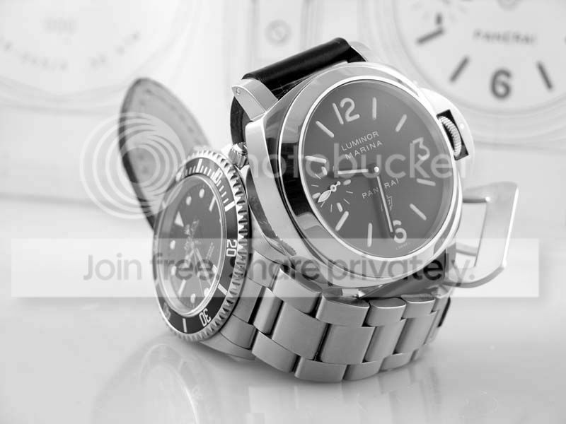

This was taken using a white plastic storage box, two 500w worklamps from B&Q and a Nikon 8700 bridge camera....
^ very nice shot, here is my pretty lame attempt, done with paper for the watch to sit on and my laptop on a white screen for attempt at some lighting. Then with my phone's flash light on through paper :P Cant get much cheaper setup than that :P

would have loved to see the setup shot for this!
It's basically one of those plastic storage crates you get in B&Q or the pound shop, turned on it's side with a 500w B&Q work lamp (the big yellow ones) on either side and an A4 print out of the Panerai blueprints for a background.
Camera on a tripod (probably in P mode :lol:), hideously long exposure and Bob's your uncle...

This is quite a nice shot - OK, not perfect but a good example of what can be done WITHOUT a lot of diffusion.
The other examples in this thread are all suffering from light reflected from the 'glass' and some are suffering from flare too. In each case it's caused by light bouncing around in an uncontrolled way from reflector boards, light tents or other diffusers, hitting the 'glass' at the wrong angle and being reflected into the lens. The trick here is to do what Cheng has done and have CONTROLLED light.

For shots like these, you need controlled lighting and a bit of drama. Within reason, it doesn't matter what sort of lights you use as long as you can control the direction and placement of the light and as long as you don't b****r it up by diffusing it too much.
