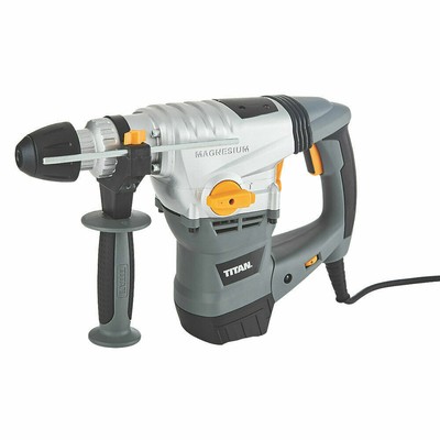

I have a grim job coming up as my old gable end in our house needs dry lining, I need to rip off all the old plaster top to bottom then will line and tank it. need a cheap sds chisel breaker any thoughts?
like this below.
1) Its cheaper at Screwfix (£69.99)
2) I bought one to lift a tiled floor and all the backing, bought an additional chisel, and it made mincemeat of the job - very impressed
3) Subsequently used it to drill an 18mm hole through 2 brick walls, again made very light work
But
It is quite heavy, and will give your arms a serious workout if used at height
I will be using a platform so should be ok, I really just needs a lot of chiselling power as the old gable en is plaster with more plaster on top....sigh
If its just plaster then a lighter (as in weight) breaker will do the job surely?
I have the one you've linked to and it's a great tool for the price, but as Mr P says, it's pretty heavy..
I also have a little sds drill/breaker that weighs a fair bit less but is so much easier to use.

Yeah I think it was @stevewestern who talked me out of buying one of those :) 6 odd kilos is a _lot_ to hold for a few hours especially if it's at height.
