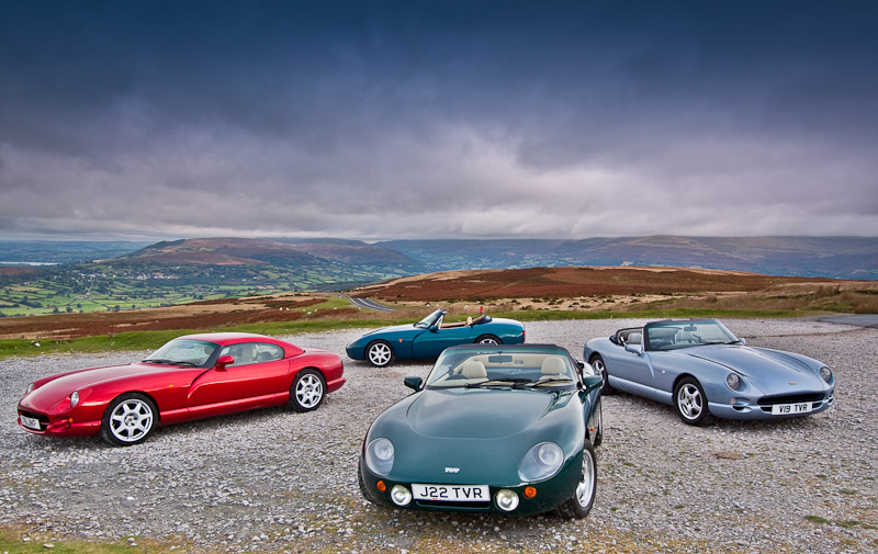

Taken for a magazine shoot. It really was that dark and grotty on the day the pics just had a minor levels tweak on the sky and some PP to remove the reflections of people from the cars

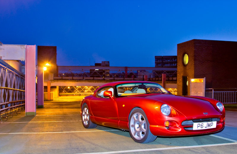

Taken at dusk on the top of a carpark. Two flashes lighting the front and side of the car just to try to overide the yellow colour of the sodium lights

The location he wants to use is a gravel car park in a wooded area but at a high point. The car park is on the edge, so it looks as if you would fall off the edge if you walked a few feet behind the car (when in fact there is a steep bank).
With the camera at the right angle the horizon would be below the back of the car.
Ideally I would like to find the best way to be able to take the car without having to worry about the sky and add a decent sky in PP. So I guess a dawn/dusk shoot with a plain sky would be best.

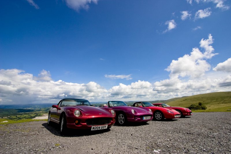

Oh yes, we have a location like that near us at Hackpen hill, close to a wiltshire white horse. You can park your car so it's on the edge looking down. Haven't got one of at the moment of those but there's a similar shot from the welsh hills
Again it depends on time of day, weather conditions. Just go prepared thinking about a couple of lighting scenarios and you'll be fine. Don't forget you can light parts of the car at atime with a flashgun (maybe walking about with a long exposure) or short exposure and add them together in post.
