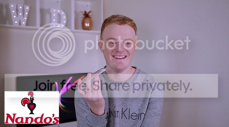

I have the white balance on auto, I think that may be a problem as if you see below the picture isn't great. My walls look green lol, they should be white
2) I don't have a clue what settings I should be using on the camera. I have the shutter speed on 1/60 / ISO 300 Fstop 1.8
In the Canon EOS Utility software I use I can also adjust the contrast, saturation and Colour Tone, but I don't know what I should have these at.

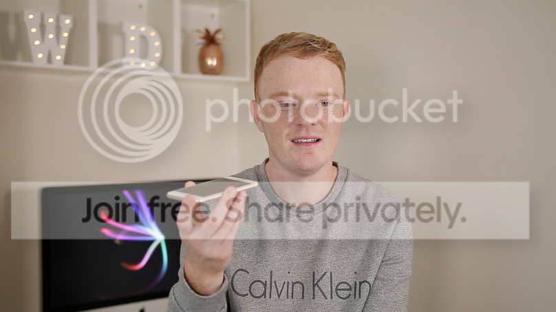

As you can see below this was what the quality came out like when I uploaded the footage to Final Cut Pro. My walls should be white.
After messing around with colour correction, which I haven't got a clue what I am doing. I came out with the below. Still doesn't look great?

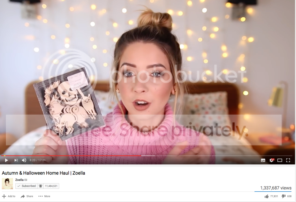

As you can see below, Zoes image quality seems much better then mine, thats what I am trying to achieve.

Auto is going to be pretty decent in most conditions but you can set a manual white balance if you like for more accuracy and consistency. FWIW your auto WB off the camera is much closer than your adjusted one, which has way too much magenta.
The in-camera JPEG picture style will affect your video (I believe, don't know your camera specifically), so you can have a play with this is you like. Setting to a very neutral in-camera style is preferred by a lot of people as it gives more latitude for tweaks in post. For YouTube talking head stuff you may prefer to just set something a bit punchier in camera and get it to something good enough straight out the camera.
You mention LED lighting, are they decent quality with a high CRI (colour rendering index - google it)? The reason I ask is that the second shot above in which you have tweaked the WB looks to have a slight purple cast and that can be caused by lower quality LEDs.
If you're comparing the 2 videos there's a significant lighting difference - the lady's much closer to the luminaires and there is some background illumination from a big window camera left and in-shot practical lights.
The CRI doesn't take account of the fact you're using a Camera and TV Display rather than an (ideal) eye. TLCI is more accurate for video use.
View attachment 96009 Here's my advice.
1. To get good audio you need a stand alone audio recorder and mic away from the camera so you don't pick up focusing, zooming or auto aperture changes. You also need to edit the audio, tweak the volume, eq, maybe add a bit of echo. Once you have a stereo audio track you can put it on the video timeline with your camera audio, sync it with the camera audio, and mute the camera audio. I use the Zoom R16 digital 8 track as my stand alone audio recorder.
2. Your video needs to be color graded. You don't need to change the tint, just tweak the highlights, shadows and saturation a bit, add about 10% black clip and 5% white clip. I use Adobe Premiere Pro as my video editor and it links to Adobe Audition as the audio editor. I edited your still in Photoshop (has the same controls as Premiere Pro) and this is what I came up with.
