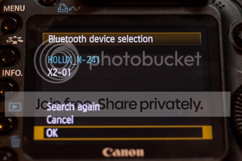

We find our Holux and connect to it:

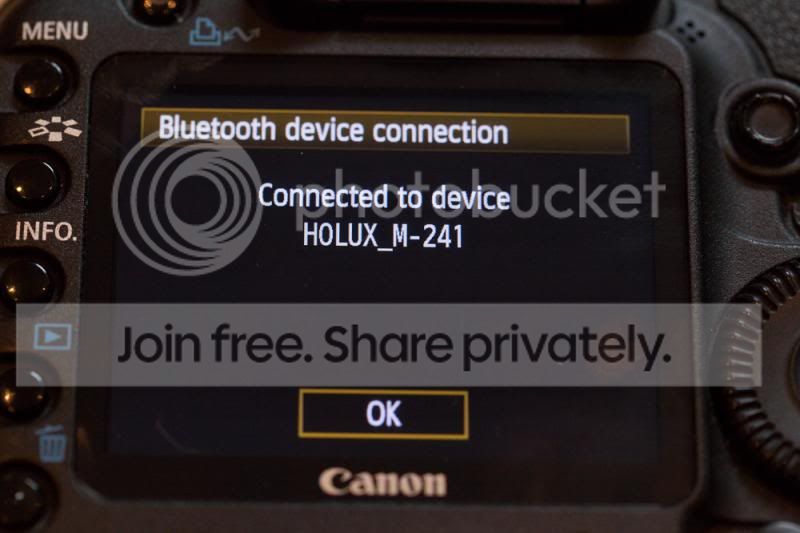

The camera confirms connection:
The USB light should be constant - the LAN light will be flashing red or green, depending on whether your wireless transmission is set up and connected properly. You can have Bluetooth GPS AND wireless transmission - it's not an either or set up.

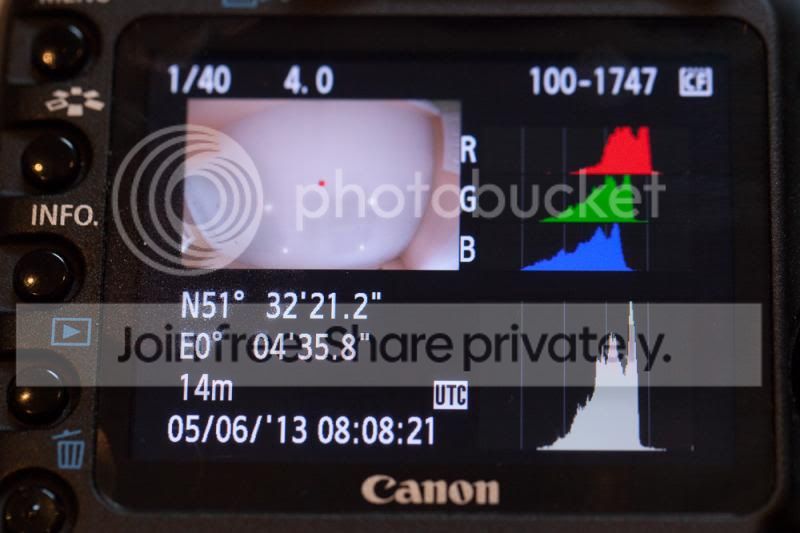

Your raw files will then contain GPS co-ordinates automatically. No need to synchronise, no need to add software to your PC, no need to worry about time differences between logger and camera, it's all done automatically and easily, as can be seen below in the screen shot of the RAW file data on camera.
