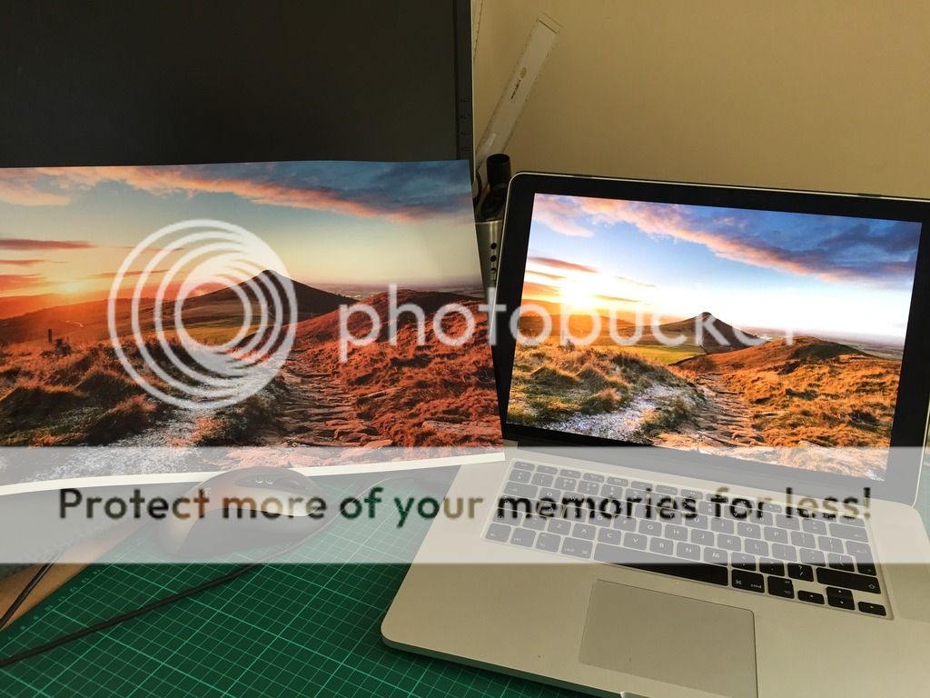

I have a Canon Pixma Pro 100 and no matter what I do it has a magenta orange tint to my images, they don't look like they do on screen. I'm using the following:
  • Macbook Pro
  • Lightroom CC
  • Canon Pixma Pro 100 (connected via USB)
I've done the following:
  • Callibrated the screen using a Spyder Display Callibration tool
  • Have all the ICC profiles loaded correctly
  • Proofed the image before printing (all looks good)
This is what I get:
I'm getting to the end of my tether and it's costing me a fortune in paper and ink.
Any ideas at all before it all goes out the window??

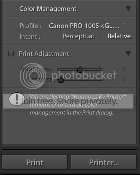

No lightroom doesn't do it for you in my experience you have to make sure the printer isn't doing double bubble management...upload_2017-4-20_20-3-19.png
upload_2017-4-20_20-5-41.png all checkboxes should be empty

I can't help re the cast - I'm reading this post to educate myself... but I think on a Mac you will find these settings in Lightroom on the bottom left hand side of the print module under 'Print Settings'. You can then select from the drop down options - Colour Options will give you the screen with the coloured pencils for example. (Mine defaults to showing 'Layout' on the drop down - click on this and you get the other options including colour matching)
You say you have calibrated your monitor BUT looking at your image of the screen next to print, the first thing I see is how dark your print is to your screen. Have you set the screen brightness before doing the colour calibration?
I run my screen about 85 Cd/m² I have found that mac's are often up in the 140 winds about 120 so not know if you have change it of not but this is my finding, as you will also get wrong colours if the screen is too bright.

This might work... in LR, you click on Page Setup from the Print Module, then Properties, then check the Color/Intensity Manual Adjustment box, then the Matching tab, then choose None the click OK until you're out.
