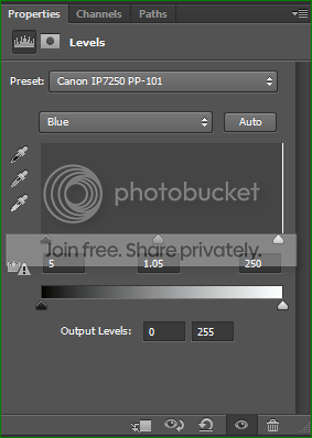

I've just screen grabbed the levels panel incase anyone was wondering what I meant.
