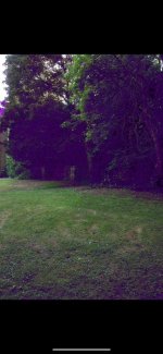

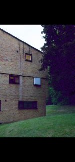

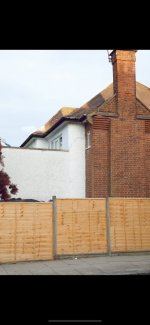

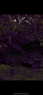

So currently having a bit of a saga after shutter broke on my 5d. It was under warranty so today was sent a replacement. Tested it on some shots in garden and there’s a weird purple tinge almost psychedelic. I then went in street and in better light against lighter background it actually looks fine. But then went back to darker background and purple is still there. I’m guessing it’s sensor ? It can’t surely be a setting ? I did think memory card but the light shot is fine. I will add pictures.
The first 3 show the purple tinge. The shot in better light is clear. And definitely nothing to do with lens.

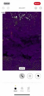

This is also really weird. If I go to edit on phone it goes even more purple.

Just wondering if anyone had any thoughts on this. Overnight I had a feeling might be corrupted SD card. But checked this morning and isn’t.

You might be able to test that theory by comparing a shot of a plant outdoors (even if it is a bit cloudy), versus indoors illuminated by flash. If the outdoor shot has the weird colours, that might confirm it is responding to infrared.
The fact that in your sample shots it is the leaves of plant that have this colour shift, seems to support an IR problem, because almost glowing foliage is a typical feature of IR photographs.
What you have shown appears to be isolated to under exposed foliage areas. NB can you confirm that the 5D is the original i.e. not the mk2 or above?

Thanks for feedback. It’s not just the leaves that are weird. If you look at the building it’s on the windows pipes. The camera is a replacement sent by a 2nd hand dealer. So I’d presume they would have reset everything to factory settings. Looking over the settings everything looks to be at default setting.

I dont think thats an IR conversion, the sunlit leaves look fine. I'd be guessing and say the sensor or processer have an issue. Personally I'd be returing it and shopping elsewhere if i'd had two duds from the same dealer.

It might be a full spectrum conversion or the IR filter in front of the sensor has something wrong with it. Try it on auto white balance (no adjustments) and compare it to the pictures half way down and in the right hand column here:
Trees let quite a lot of IR light through their leaves (like a giant soft box) so it might be the purple in the shadows is IR light. It only shows up in the darker areas because in direct light the normal light dominates. IR will mainly show up on a sensor in the red and some in the blue band, making purple.
