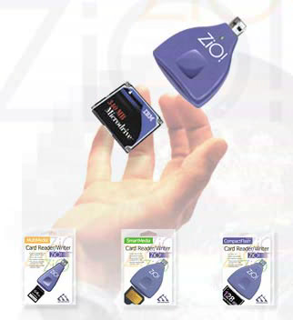

Can't really help with your problem I'm afraid, other than agreeing with Ken that if your printer has a card reader why connect the camera?
I have a couple of mates in the camera repair trade who tell me that constantly plugging and unplugging USB connectors into the camera socket can lead to the soldering breaking down in the camera socket and eventually, cracking of the internal circuit board to which it's connected. This can be an expensive repair and apparantly all digital cameras are susceptible regardless of cost. Apart from this , having your camera connected to the PC via a USB or serial cable and possibly also a power connector too, the possibilities of accidentally dragging your camera off your work top by catching one of the cables are very real.
If you haven't got one I can't recommend a card reader enough - they're as cheap as chips. I use one of these...
I just plug mine into the USB port on the front of my PC and I could easily do the same with my printer. It's much more convenient, far safer, and you no longer need battery or mains power to upload you pics to the PC. It also has the advantage that if you're out shooting and fill up your CF card then if you have access to a laptop, you can upload your pics to the laptop and carry on shooting.
No drivers are required btw Windows just finds the card reader as a removeable drive.
