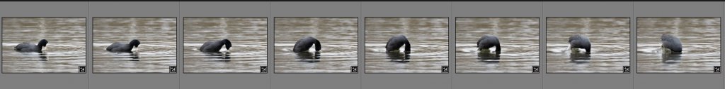

This is part of the sequence - not BBC Life on Earth but I still wanted to see what I'd got, the point where I pressed the shutter was about 3 frames to the right just as it vanished under the water!
