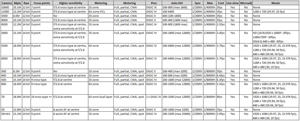

As far as I'm aware the 600/60/7D all share the same basic electronics - including sensor. The difference is camera size/body and some processing niceties as well as better focusing sensors for the 60 over 600, the 7D has better focus system again and mag alloy body. This might help you understand more clearly.
