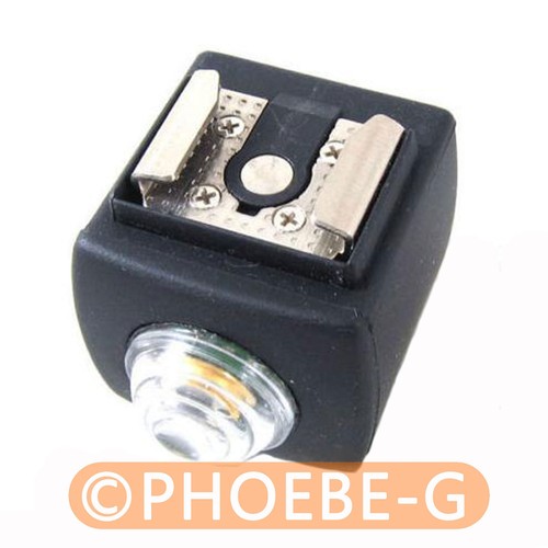

All is not lost, I quite often use other flashes that are triggered by a device that fits on the flash hot shoe, and detects the flash from the camera to trigger the flash it is attached to.
They used to only cost about £5 each.
They don't work if the camera flash flashes more than once to reduce red eye, or to assist focus.

Thanks but the flash I use is a dual flash and I am not sure if that would still work or rather if it would still fit on it.
If you are talking about the remote triggers, any flash that fits on a standard hot shoe and is triggered from the centre pin will work, including old flashes that would damage a modern camera.
Thanks sadly but would they be fired if external flashes don't fire.
The trigger has a hot shoe fitting on the bottom, useful for a small foot if you have a flat surface to put it on, they also have a threaded hole to fit it onto a tripod or similar
