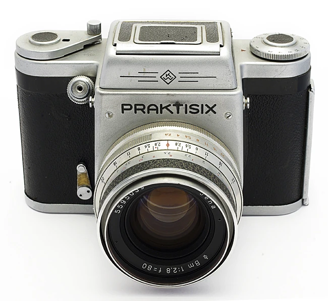

Many of the rangefinder cameras from the 1930s to the 1960s would sit level with all except the longest lenses. This was due to the cameras being made of heavy materials and the lenses being, in relative terms, lighter. (This led to a candid photography technique of fitting a longish cable release and taking the picture while the camera hung at the waist.)
When SLRs came on the scene, the lenses became bigger and heavier for various reasons No one took the question of how the camera should hang very seriously and traditionally designers put the strap lugs on each end of the body, hence the down tilted SLR became more or less standard.
One or two cameras went against this trend, most notably the East German Praktisix and its offspring, the Pentacon Six, with the lugs at the very front on the sides of the viewfinder housing. Interestingly, when Arsenal made their own copy of the Praktisix, the Kiev 6, they moved the strap lugs to the front edges of the main body.
