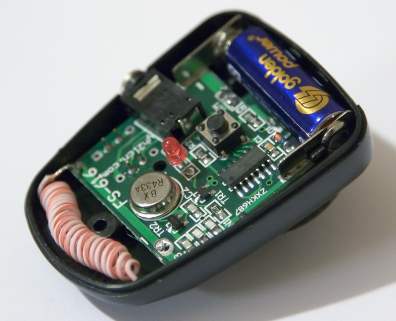

This is my own mod version after reading all of the following forum threads and blogs:

I used this frequency wavelength calculator to get the correct length of wire I needed to use.
I have tried 1/4 wavelength but sometimes I couldn't trigger the receiver. Then I tried 1/2 wavelenght with success.
The length of the cable I used was 13.64 inhes minus 1.25 inches (this is the length of the trace infront of the trigger's PCB). In short I used 12.39 inches of cable approximately. Take note that in no.7 tutorial the end of the cable was soldered to the right of the trigger, while I soldered it to the left (end of the trace).
Now wait a second, you might say why is no.7 tutorial my favourite, but I did not use the materials mentioned? Simple answer is the cost!:shrug: And I cant wait for a few more days for delivery!:nono:

Before I forget, the cable I used is here:
I stripped an old Cat5e cable. The one that came with my wireless router!
Here's how the modded reciever looks like:
You might notice the battery is a different brand from what normally ships with the trigger, I bought that from maplins for£1.30. B&Q also sells them cheaper.
Overall I'm very pleased and satisfied with this mod which has increased the triggering distance.
