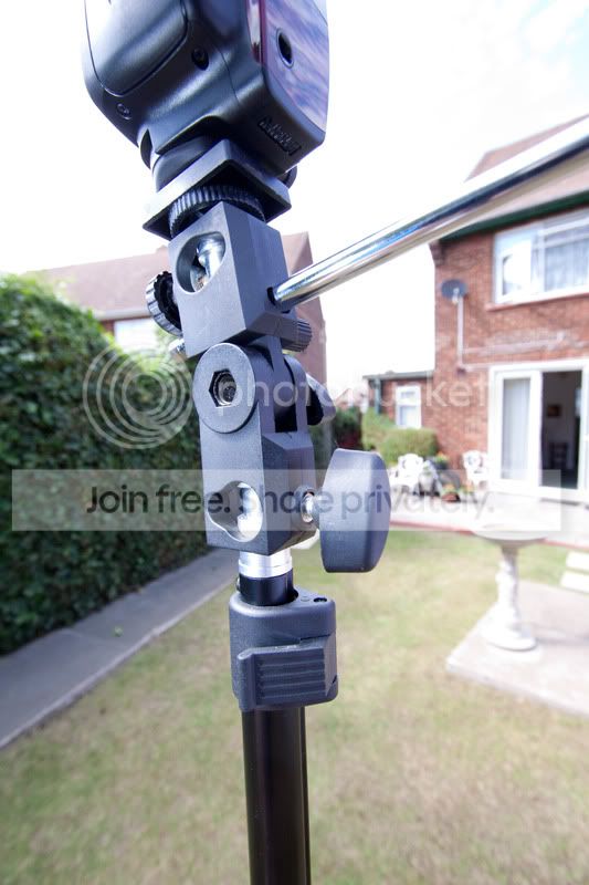

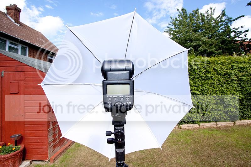

£10.99 flash stands from 7dayshop - do the job well, come with neat little carrying cases.
$8 flash brackets from dealextreme - do the job ok again, though for recent nikon speedlights, get the 'single hotshoe' size one that's £6.50 with free shipping on ebay instead.
$6 white shoot through umbrellas from dealextreme - again, these do the job fine, whatever umbrella you buy, it'll blow over in the wind at some point and die, far rather have a £4 umbrella die than a £30 one.

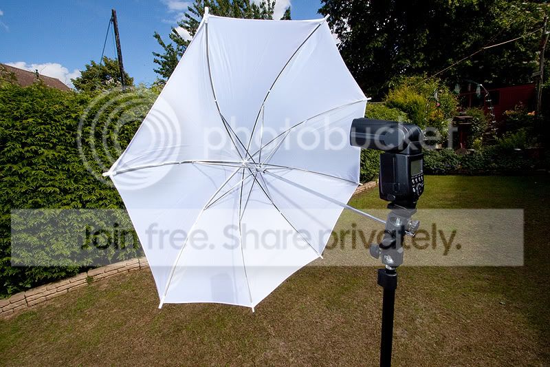

Quick Q...doesn't using v4's + stand/umbrella mounts put the flash above the ideal line for the umbrella?
Yup, it does really, but if your flash has a PC sync socket you can just buy PC sync cables and attach the flash directly to the coldshoe mount and hang the V4's off the side on a lanyard.... some of the V4's seem to come with the socket and others don't depending on the branding that's on them - my old V4's never and I had to buy a PC sync to hotshoe adaptor as well...

I wouldn't mount the V4's on the lightstand and then the flash on top of that anyway... very unstable and asking for a flash lying in pieces on the floor...
Yep, there's no-way to 'tighten' the V4's to the stand so I always use the 580EX II's directly on the stand with the V4's hanging.

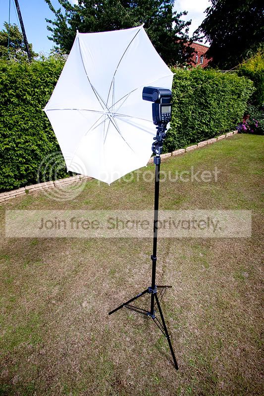

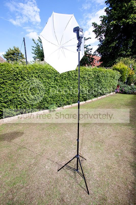

I have had a few shoots with these now, and although they do tend to blow over easily they are cheap and cheerful. The only reason they blew over was because of the umbrellas which is gunna happen on pretty much any stand unfortunately. When it got really bad I removed the umbrellas and they stayed up just fine.
