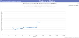

This chart (LINK) shows how much actual benefit there is to raising the ISO on your G9. As you can see it maxes out at .39EV (ISO 1000). It's always less than 0.5 EV which is about the minimum needed to be visually perceptible.
What that means is that you could take every picture at base ISO (200) with essentially no penalty. Images where you don't record enough light (Ap/SS) will still look just as bad when recovered as they would if you had used a higher ISO to compensate, but they won't be notably worse. The big advantage is that you can selectively recover the underexposure, whereas ISO is global.
So my advice for the G9 is to drop the ISO anytime there is any doubt.
And you don't have to be careful about how far you drop it; as long as it's at least enough to prevent the ISO from pushing the highlights into clipping.
Thanks Steven, I usually manage to keep the ISO low with slow shutter speeds but I need to set a limit in my auto ISO and use the live view more.
I appreciate you taking the time to show me this.
